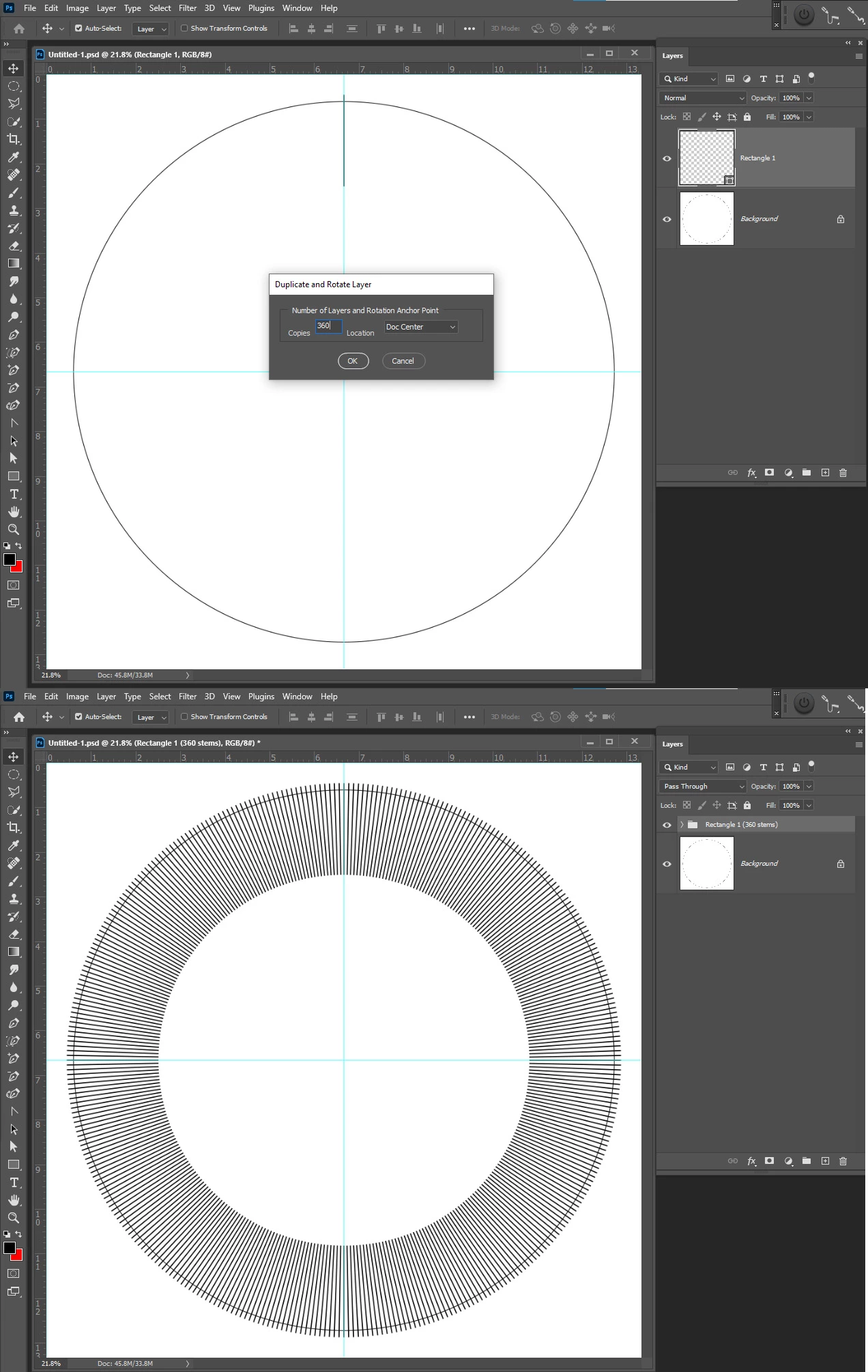

November 4, 2020
You could use a script like my RotateLayerAbout.jsx to rotate a line layer about a point.  However for 360 lines you will need a thin line and a large radius. It will take some time to run and you cam merger the 360 layer in the layer group created.

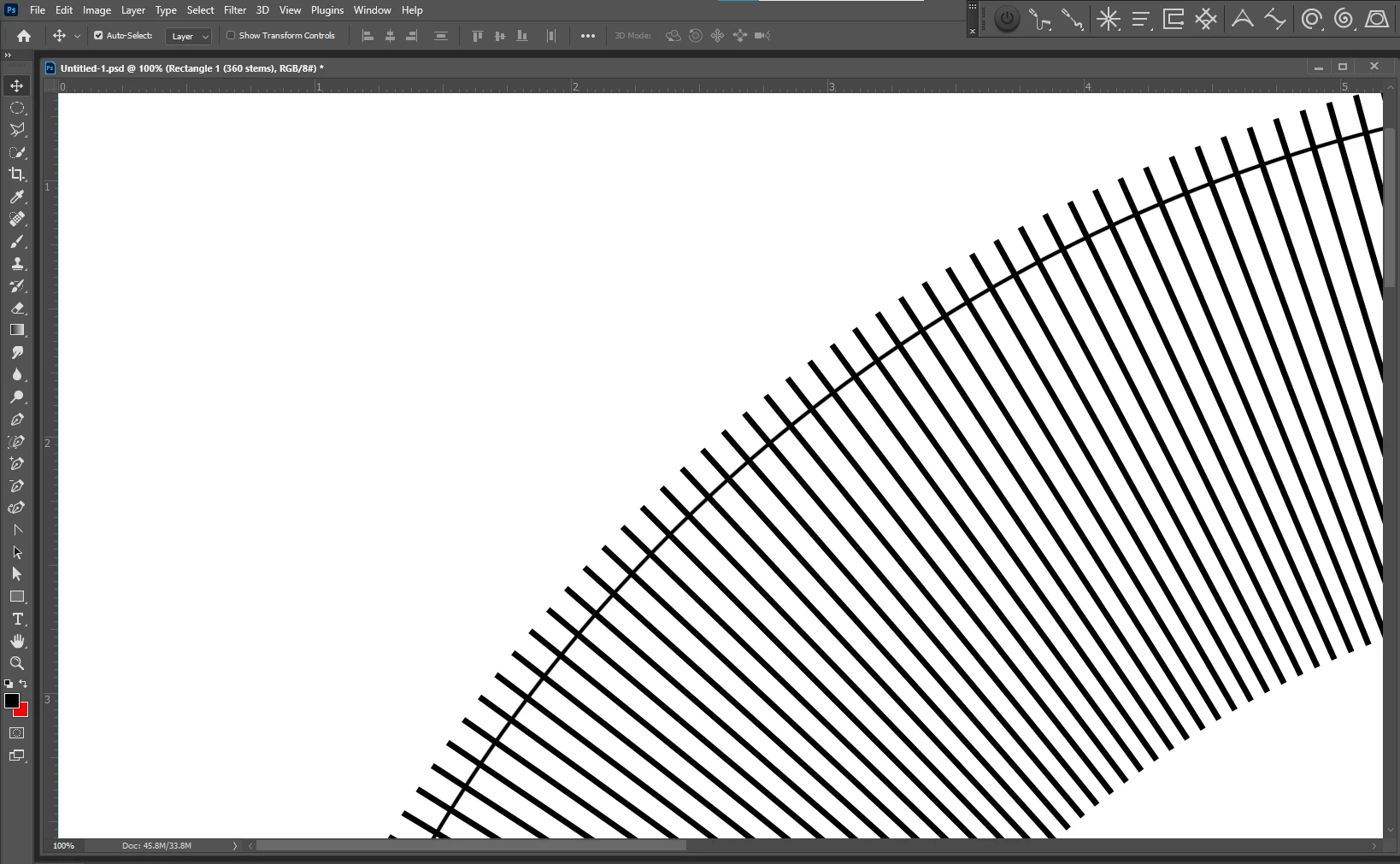

November 4, 2020
Thank you for this suggestion! But as far as I understand, I can only measure with the ruler tool not draw with it. I'm wanting for each line on each degree to be visible (something like the image in this screenshot).
