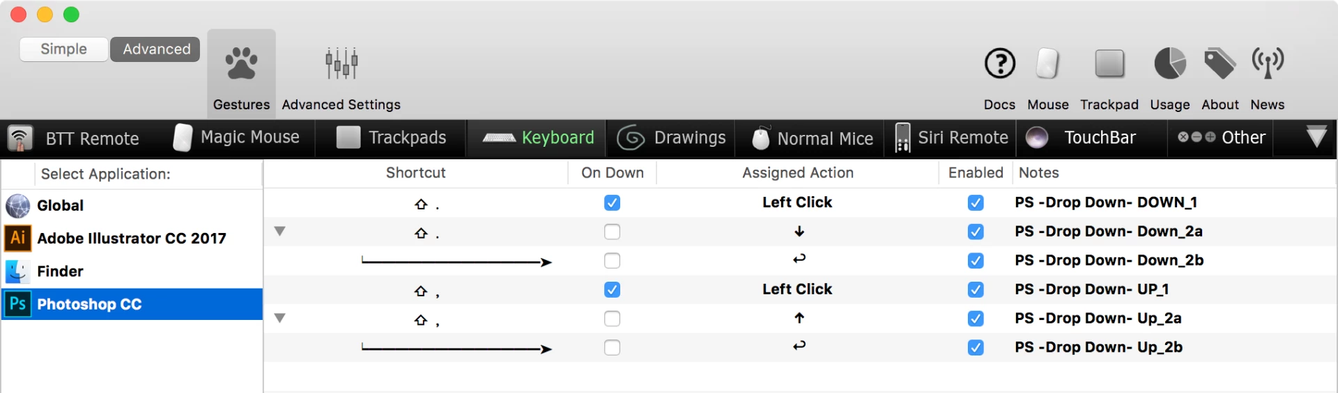

Though I didn't figure it out through the actual OS, I DID find a workaround using Better Touch Tool.
The Mouse has to be hovering directly over the drop down bar name because a "Left Click" command is sent, but it's not really an inconvenience since I at least get to scroll through drop downs on a Mac, which I've been trying to do since I got my first one 9 years ago.
So, yes, I'm marking my own answer as correct. If someone figures out how to do this on the OS level without using a 3rd party tool, I'll change the "Correct" answer to them. Hope some of you find this helpful

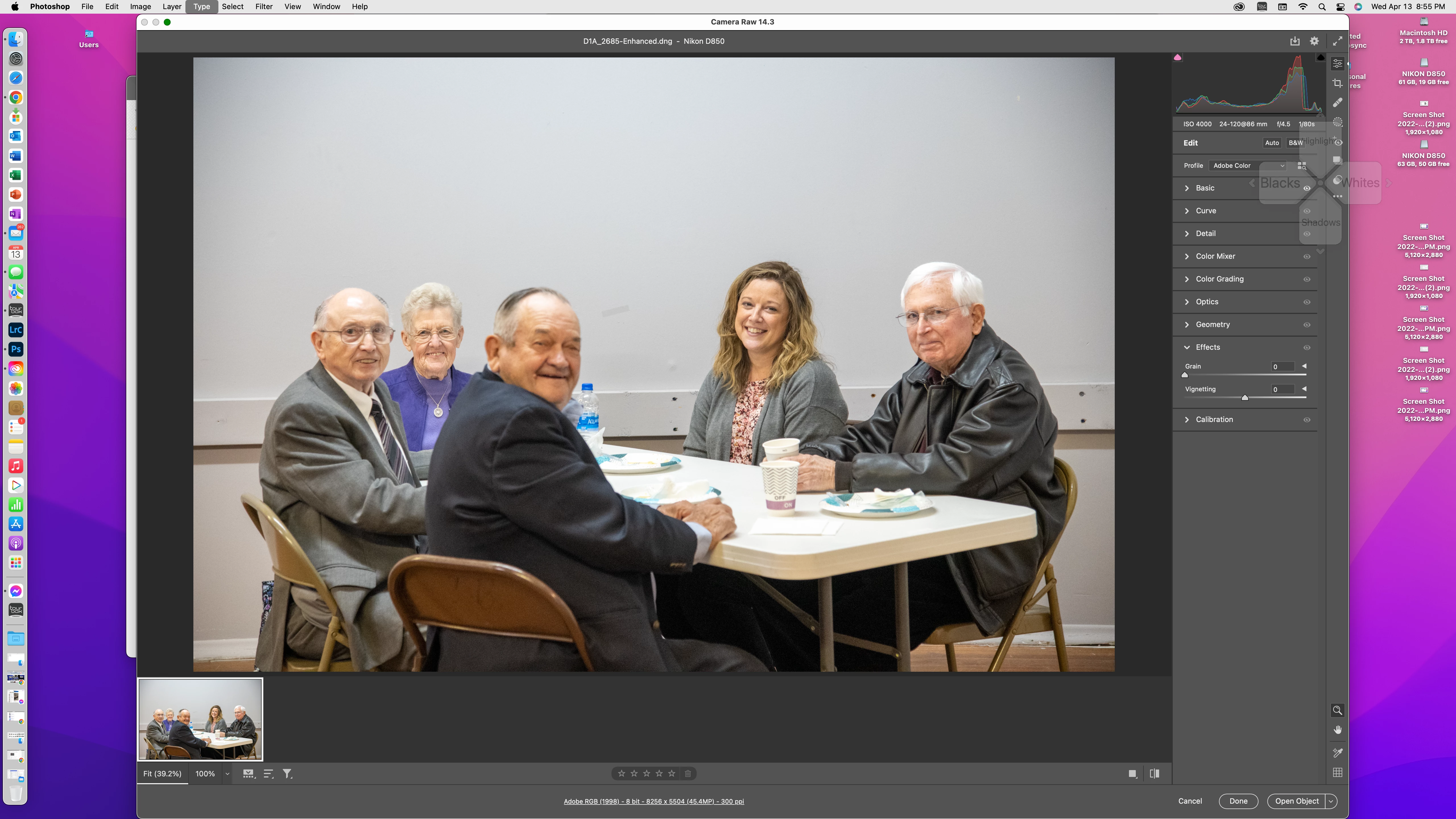

As can be seen in the screen shot below, photoshop dropdown menus are not working.  How can I fix this problem?  None of the solutions on the web have been helpful...
Thanks
Robert

Mykill GAuthorCorrect answer
May 27, 2018
Thanks to all who replied...
Mykill GAuthor
May 27, 2018
BTW
The order and checked/unchecked option of "On Down" are crucial to making it work.
Once the shortcuts are made, you can drag "Left Click" into the "sequence", but it stops working regardless of order. I tried it as many different ways as possible and only this sequence worked.
I chose Shift+ (<) & (>).
It displays as Shift(.) & Shift(,) which is technically correct, but the logic being that it was:
1- they were sort of arrow keys at least in appearance
2- Shift (minus) & Shift (plus)  [I can't type in the actual +/- keys in parentheses or it turns it into a f#@%ing emoji] are already used for changing Blending Mode on a Mac
3- the keys are close enough together that it's not too difficult on the hand.
Obviously, you can pick whatever you like, but those worked the est for me after trial & error.
