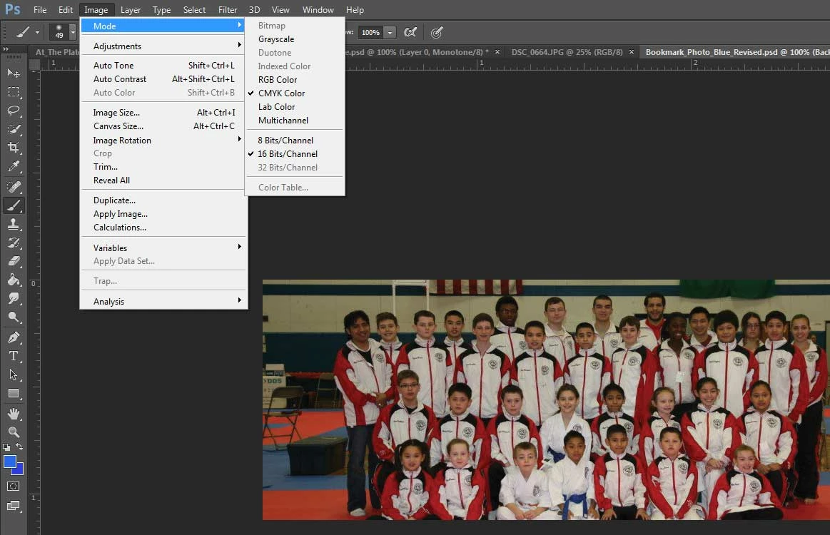

Hi - trying to convert this image to duotone but no option to select that.  Any ideas why?  Duotone is grayed out.
Correct answer Chris Cox
You need to be in 8 bit/channel grayscale, not 16 bit/channel CMYK.

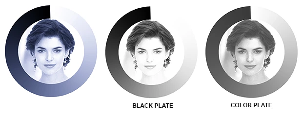

1. Image > Mode > Multichannel (Note the two channels in the Channel panel.)
2. File > Save as…  In the Format field choose Photoshop DCS 2.0
A reminder: File resolution in the printing size of the image should be one-and-a-half to two times the intended halftone screen fineness.
(The gray scale ring is provided as a hint to each channel’s tone curve.)

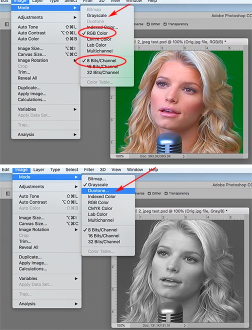

We assume it is a jpg or psd file and the file is sRGB or Adobe RGB.  Also, you have tried this with more than one file.
If not, let us know.
With the settings set to the circled items, click on Grayscale
The image should look like the bottom illustration and Duotone should be accessible.
Click on Duotone and follow the instructions provided in my earlier Post.
If. following these instructions, Duotone was not available, reset your Preferences.

May 14, 2014
You need to have it in 8-bit Grayscale, first, right?
May 14, 2014
Even set at 8-bit duotone still shows grayed out.
Chris Cox
Chris CoxCorrect answer
May 14, 2014
