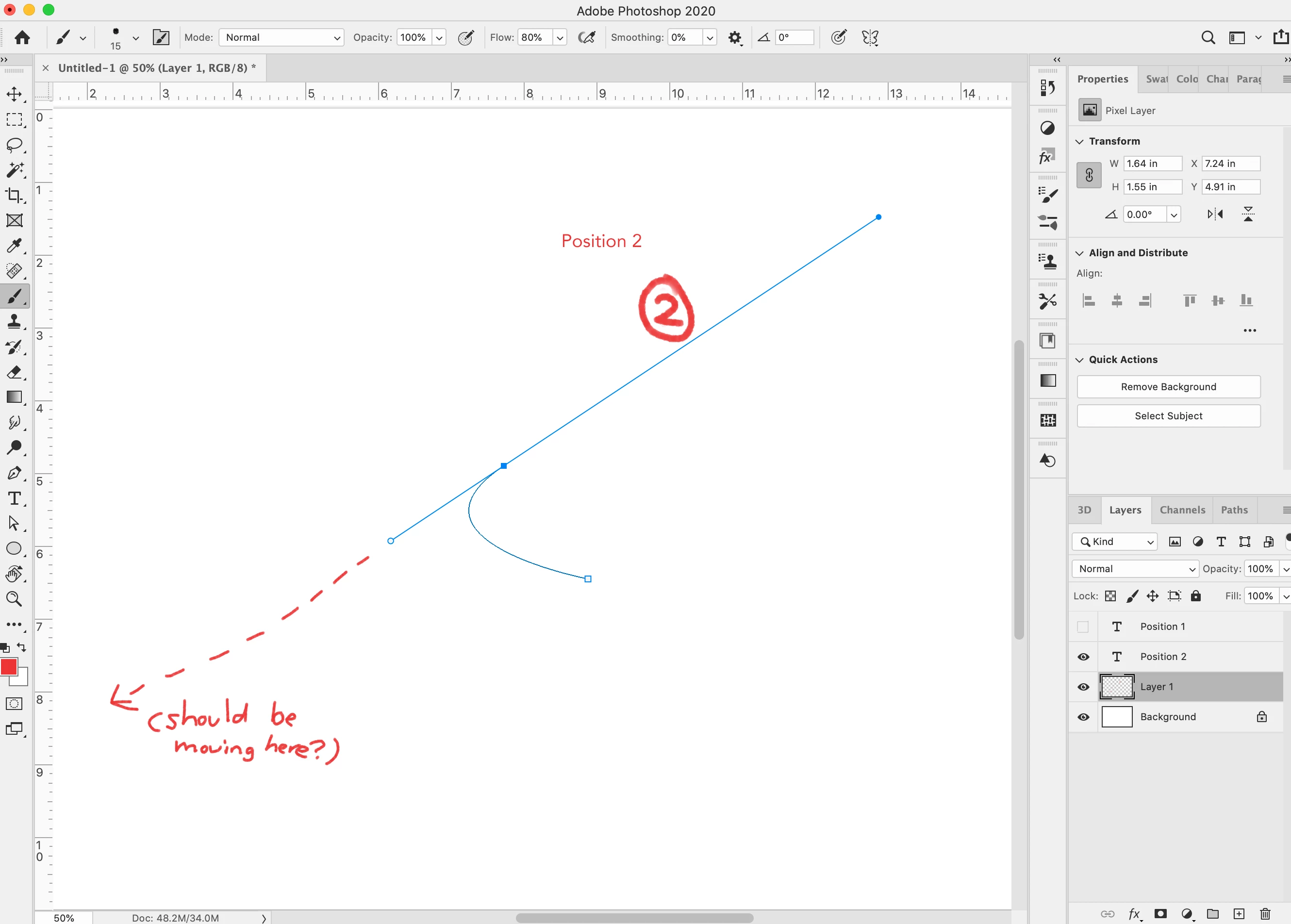

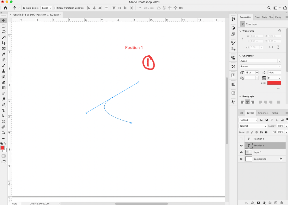

Hi! I'm trying to use the Pen tool in Photoshop. I'm confused because I'm trying to edit the path using the handles. I hold the option key to get the direct selection tool and click one of the handles and drag, but when I do, it seems that it is making the handle move independently (if I drag it longer, only that handle gets longer, not both at the same time.) I am trying to do what is described starting at ~1:54/55 in this video:

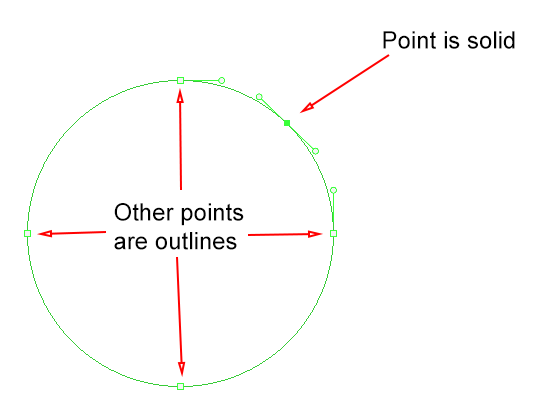

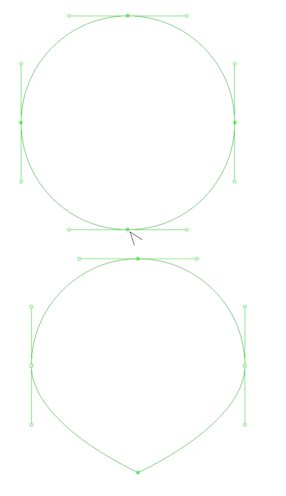

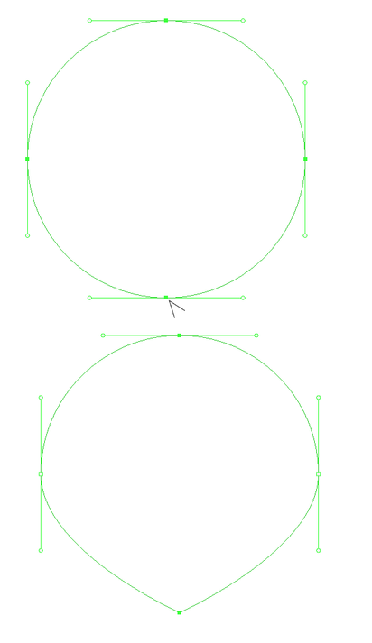

When laying down points with the Pen tool, if you click and drag — even if it is the tiniest movement of the cursor when you click, then that point will let you create a curve by draging the handles.  If you want to edit an existing point, then you need to use the Cmd (Ctrl) key and not the Opt (Alt) key.  What the Opt key does is toggle a path point between a curve and a corner.
So in the same two workpaths below, holding down the Opt key and clicking on the lower point in the uper workpath, will change it to a corner point as in the second image of the same path. You will see the cursor change into the icon you see under that point in thee upper path.

However, I'm still confused about how she is doing what she's doing when starting at 1:54 she says, "To edit your path with the anchor point, again just hold down command you can pull that anchor point around." Specifically, in the video, it shows that when she drags on the anchor point (after letting go of the Pen tool, then re-clicking the path), both handles are moving equally in opposite directions. My problem is that when I drag on the anchor point, they are not moving equally. When I drag one handle in a certain direction farther away from the center, the other handle is not reciprocating. You can also see my two screenshots for what I mean.

It sounds like you want the mofidier key for the Direct Selection Tool (press Control while the Pen Tool is active), not the Convert Point Tool (press Alt while the Pen Tool is active).
If you Alt-click a tangent of a Smooth Point, you convert it from Smooth (tangents on both sides  move) to Corner (tangent moves on one side).  From that point onward it remains Corner if you Alt-click either tangent.  You can undo to restore the point to Smooth from Corner or click and drag the point and redraw it as Smooth.
