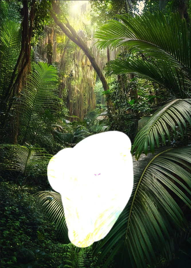

"Enhance Detail" issue - white layer
Whenever I try to use the "Enhance Detail" tool, it does not work and a white layer is generated (see the screenshots below). The issue occurs in both 8-bit and 16-bit images.
My setup: Mac Pro (Late 2013) 64GB RAM on Monterey 12.7.5 and Photoshop 25.11.0
According to PS my graphics card is compatible (OpenGL, Metal active, and 2GB VRAM)
