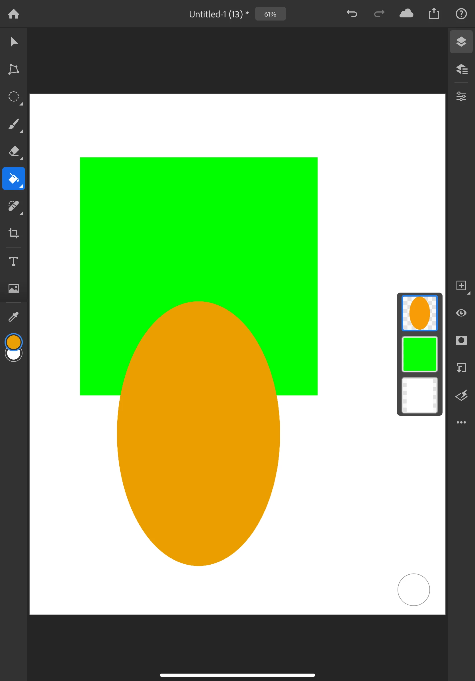

  • Tap + on the taskbar on the right to create a another new layer.
  • Tap on the color chip on the toolbar and select a different color.
  • Touch and hold the select tool in the toolbar on the left and tap the elliptical marquee tool to select it.
  • Click and drag to create an ellipse.
          (*TIP: holding a finger on the adjustment modifier will constrain your shape to a circle)
  • Tap on the fill bucket on the toolbar and tap inside your selected shape to fill it with color, just as we did with the green square in the previous layer.
  • Tap deselect on the active selection properties bar at the bottom of the workspace.
  • Now you have two shapes on two different layers.
