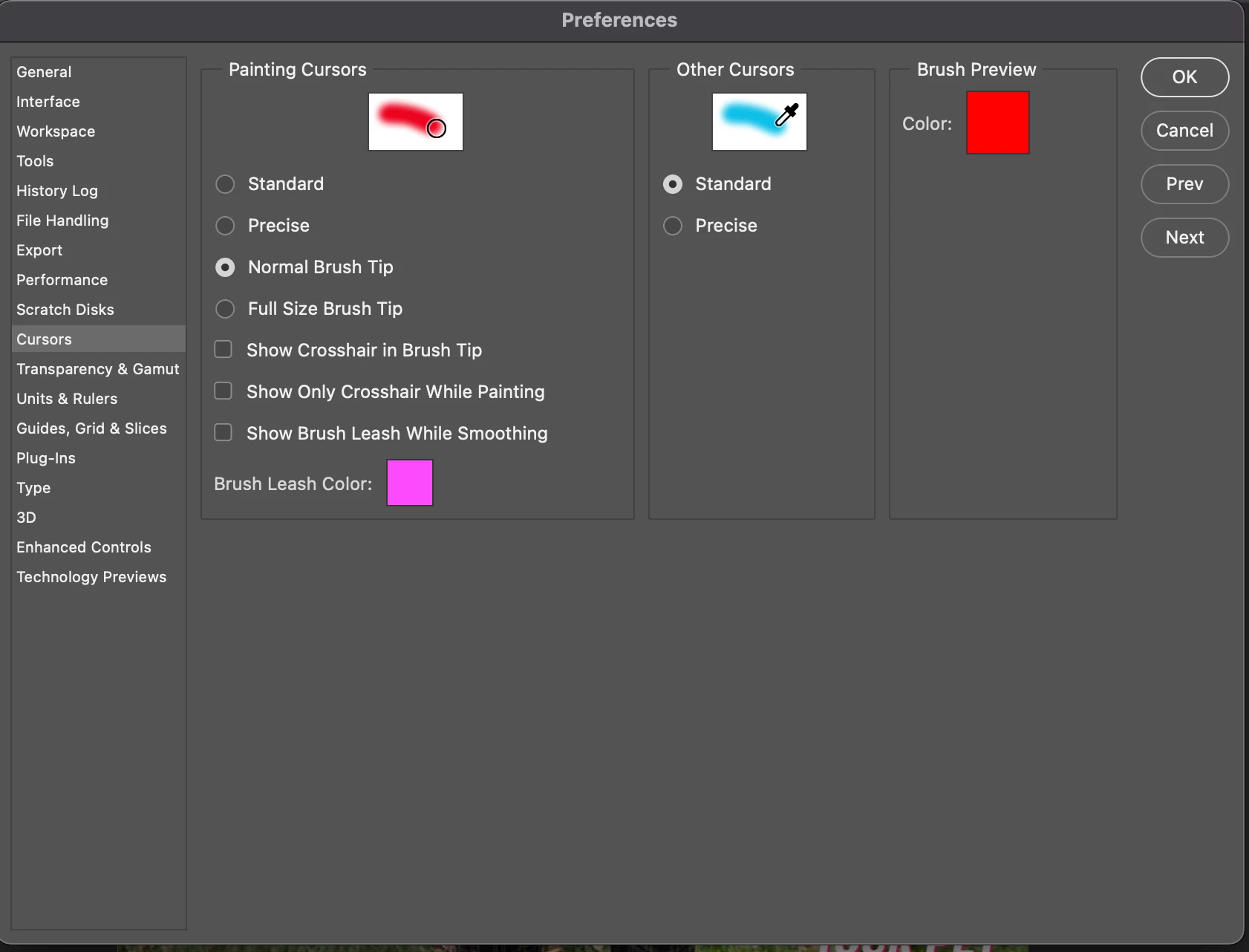

Hi there, I've been using photoshop for years and have never had this issue before. Everything was working fine until suddenly my eraser tool seemed to appear as a crosshair rather than the normal circle cursor I usually see. When I apply it to my photo, it erases the whole subject matter rather than the particular area I am applying it to. I have tried the CAPS Lock thing, I've tried to adjust the cursor in preferences, restart the app but nothing seems to work. Any help would be much appreciated as I have an assignment due soon.

Could you please post screenshots to clarify what you get, what you want, what the settings are?
Dec 13, 2023 5:02 AM UTC
Thanks for responding.  I had already checked cap locks and all of the usual issues, but no matter what I did I could not get rid of the crosshair cursor.  I also checked the cursor and it had normal brush tip selected.  I finally deleted photoshop and re-uploaded and then re-set tools and that finally did the trick.

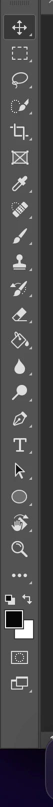

Have you reset the Tool yet?
Could you please post screenshots with the pertinent Panels (Toolbar, Layers, Options Bar, …) visible?

Please don’t just post snippets but »screenshots with the pertinent Panels (Toolbar, Layers, Options Bar, …) visible« – simply the whole screen for example.
What have you done for all-purpose trouble-shooting so far?
Restoring Preferences after making sure all customized presets like Actions, Patterns, Brushes etc. have been saved might be a good starting point:
https://helpx.adobe.com/photoshop/using/preferences.html
https://helpx.adobe.com/photoshop/kb/basic-trouble-shooting-steps.html
