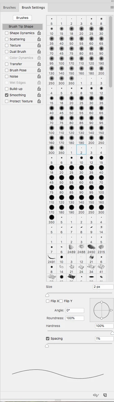

    Another solution is to make a new brush for use with the eraser tool, go to Brush settings, and uncheck the 'Transfer' box. For examples, I have a brush with Roundness 100%, Hardness 100%, Spacing 1%, and the only box ticked under Brush Shape is the Smoothing box. That did the trick for me without having to alter my Wacom settings. (Photoshop CC 2018)

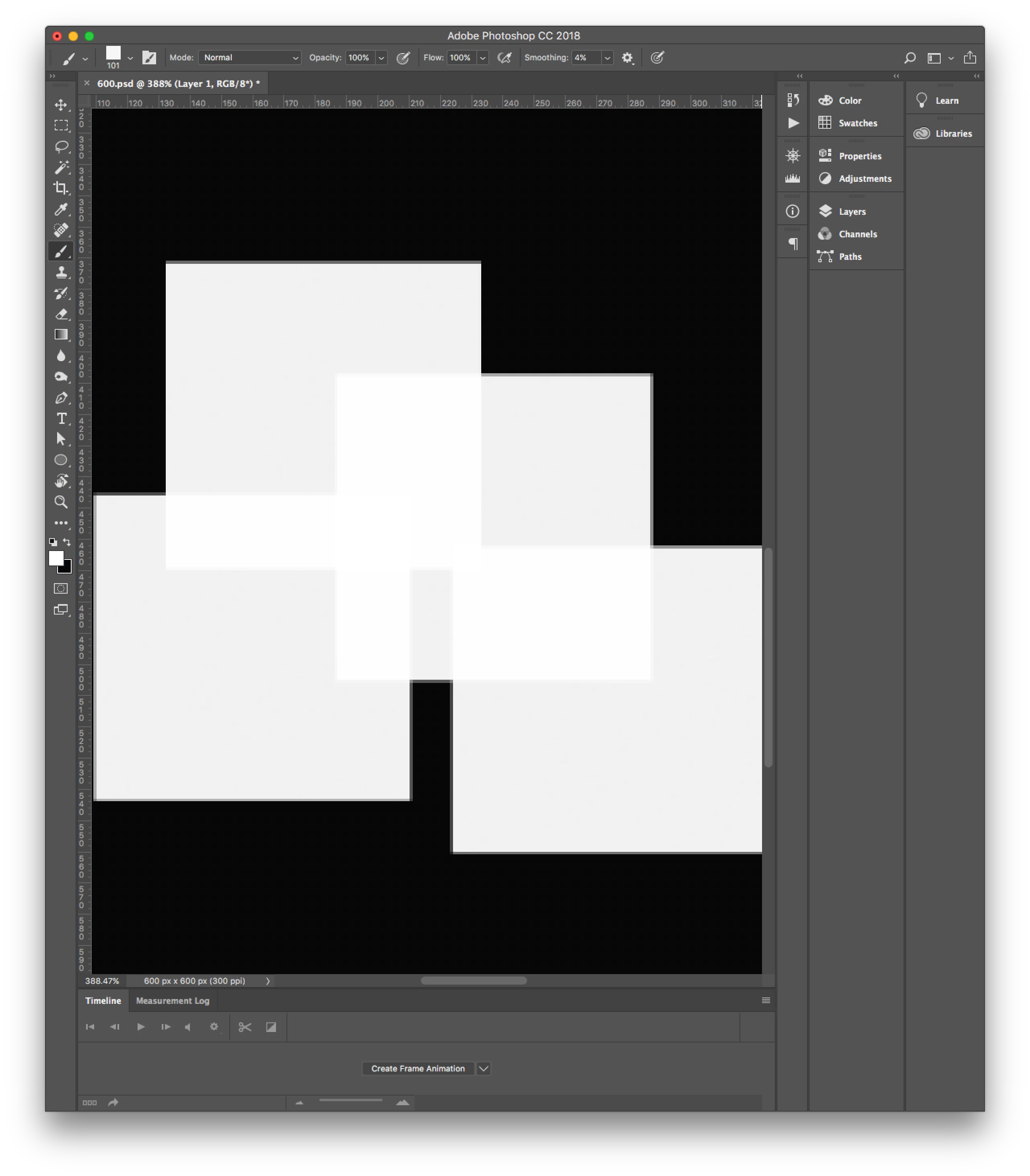

    May 15, 2018
    Is it possible that the brush you are using to erase with was made at a setting below 100% opacity.
    This would cause such behavior even if the Eraser settings were one hundred percent. So for extreme examples sake, a brush that was only 50% opaque when it was made will only erase (or brush) at 50% opacity.
    To test, use the same brush as a brush and paint white on a black area then again a few pixels to one side.
    Example.

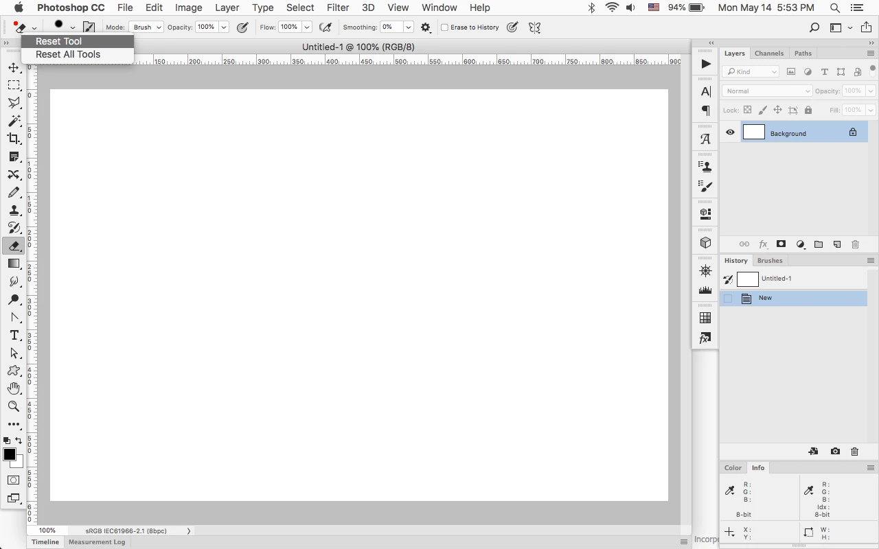

    May 14, 2018
    What version of photoshop and operating system are you using?
    Try resetting the Eraser Tool by right clicking on the big Eraser Tool icon and clicking on Reset Tool.
