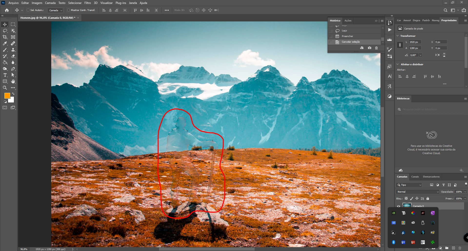

Olá pessoal,estou passando por um problema ao aplicar o Content Aware,o personagem fica com cantos ao aplicar a ferramenta,como posso resolver isso ?

Try adding the shadow to the selection and expanding the overall selection. When you have made the selection, go to Select > Modify > Expand... and enter how many pixels larger you'd like the selection to be.
You can also feather this selection by going to Select > Modify > Feather... and adding a how many pixels from the edge that you would like to feather. If you add feathering, make sure that this value is not larger than how many pixels you set to expand the selection or else you'll see the remanants of the original content similar to what is shown in your screenshot.
