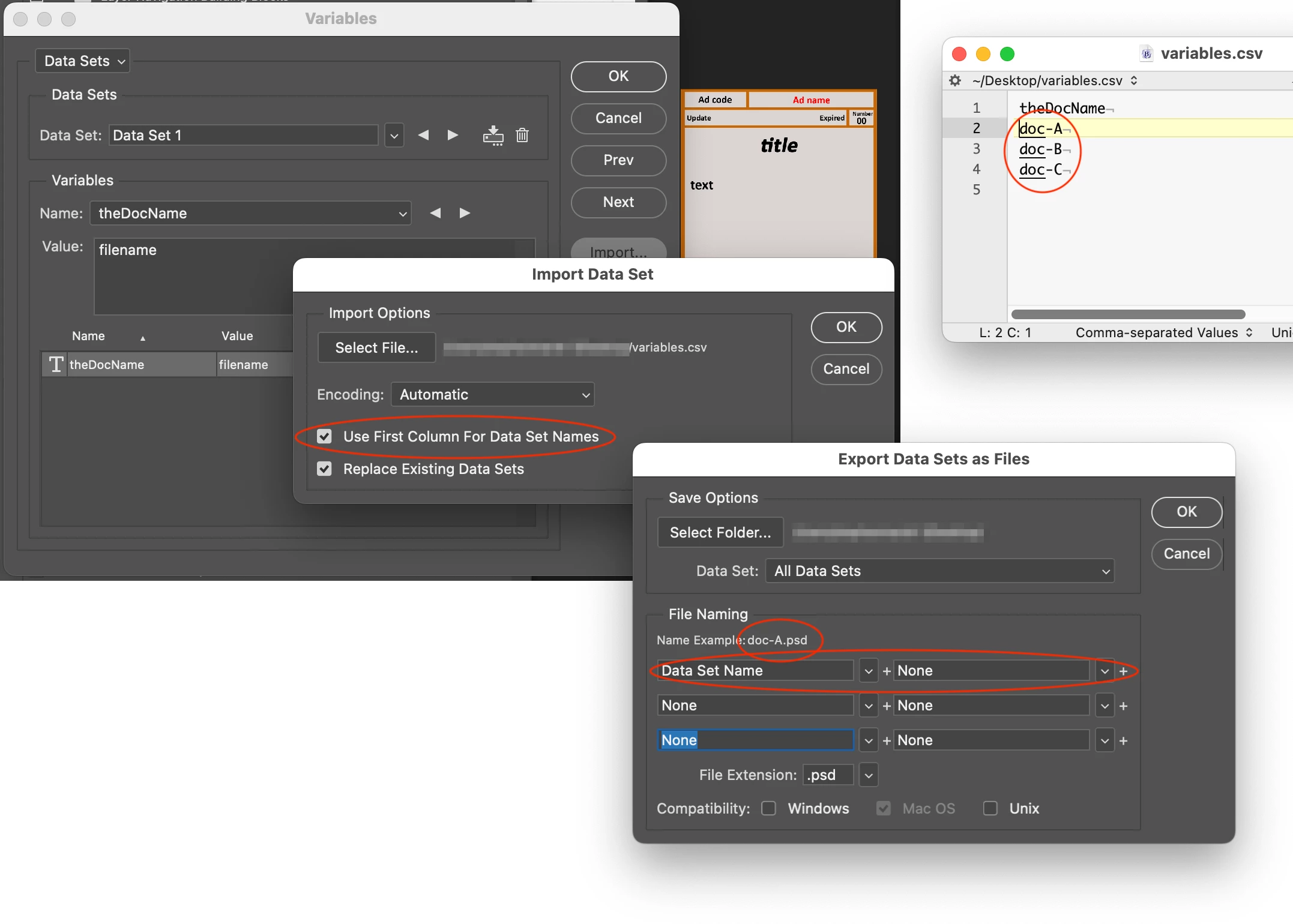

Yes, just setup the first column in the spreadsheet as the variable that you will link to the filename layer for text replacement when importing the data set.
When exporting the data sets as files, export using the data set name.

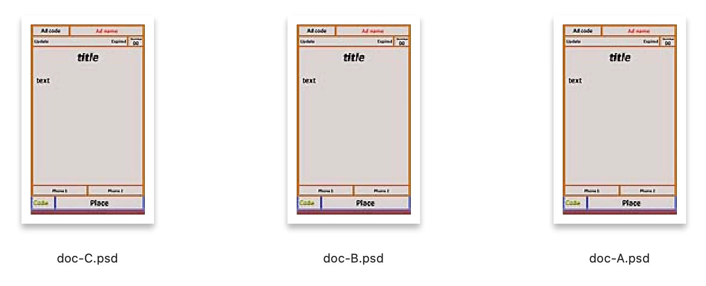

The final result with the files named after the first column:

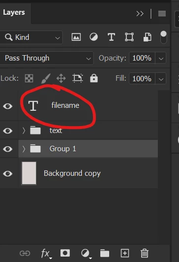

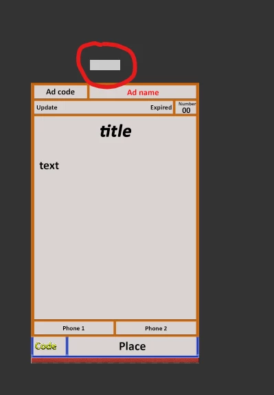

Thank you Sir for giving me a hand! This is my layers set, the 'filename' is always at the top and will also be filled with variable content, so it will be change with the set for sure:
For not to affect other contents, I will put the 'filename' far from the view area. The file will be saved as the content of this 'filename', so this is the only effect of this layer. I will send you a sample of this file

Looking at the screenshot the previous ExifTool or two Photoshop scripts should do the job as you are not using layer groups or artboards.
