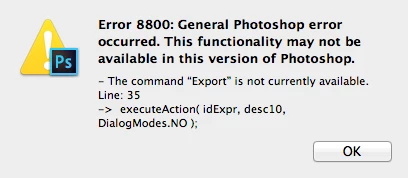

Avinash VAuthor
March 14, 2014
Thank you for the help....
When executing the script I get this error for the last line of the script.
I'm on Photoshop 14.2.1 x64
Is there something i'm doing wroing?
Thanks again for the help.
