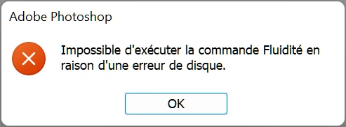

Roger Breton
October 20, 2022
Updating to 24.0.0 alone did not solve the problem.
But I ran for the first ime into this message, when I tried to access the Liquidity tools :
At first, I checked my "Disks" preference and only the C:\ was checked. So I checked a few more and, the second time around, I was able to make my way into the Liquidity tools. But the face detection problem remained unsolved?
So I enabled the "Older GPU mode (pre 2016)" in the Technology Preview and that SOLVED THE PROBLEM! Wow!
THANK YOU!!!

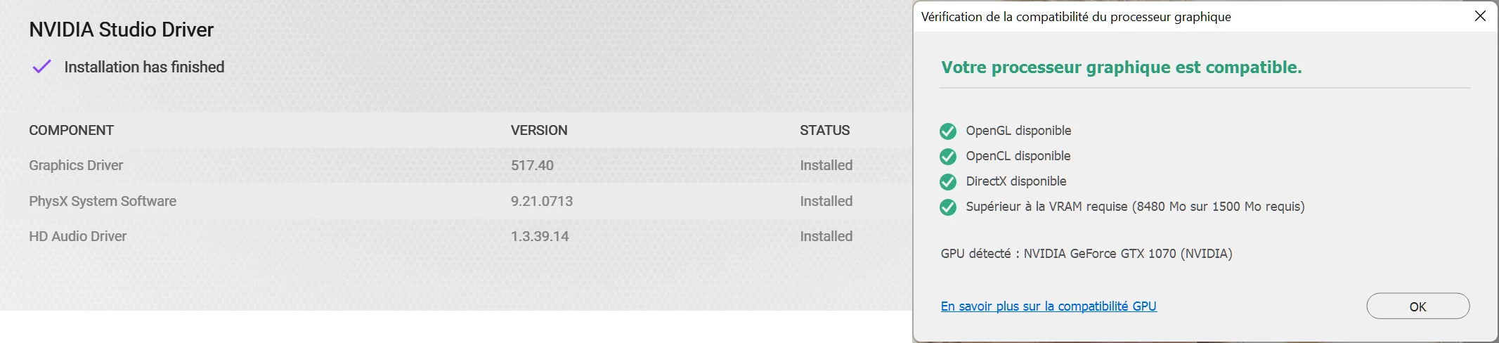

Roger Breton
October 18, 2022
I upgraded to the latest GeForce driver it still does not work.
I attached a copy of my NVIDIA driver version and Photoshop's GPU Compatibility report.
