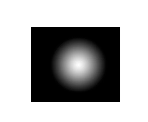

October 8, 2023
did you want it that way?
October 8, 2023
Thank you for your reply. That's the idea but not quite so feathered. I would just like to take the hardness off the edge of the circle. Make it slightly feathered.
