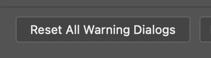

Oct 10, 2025 4:10 PM UTC
Hi @Nikou65 First for the dialog warnings. Go to Photoshop Settings/ General and click "Reset All Warnings Dialogs"
Second for your print issue - how large is the file itself? It may be exceeding print sizes.
Otherwise if you hold the space bar down when you go to File/Print it will reset the print preferences. That may work.
Nikou65AuthorCorrect answer
Oct 10, 2025 6:41 PM UTC
Thanks very much for your answer Kevin.
I did manage the dialog warning.
And my file 20X20cm for 20,4Mo Not that big. I did print much bigger and heavier before.
Only solution I found is to reset all PSP Pref …/…
The print dialog window is back, but it won’t print, thinking for ever before not printing…
I’m gonna go on Utbe to maybe find a tutorial for the setup before printing.
Thanks very much. Best regards.
