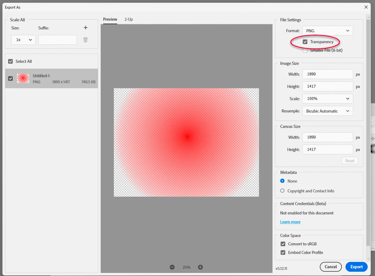

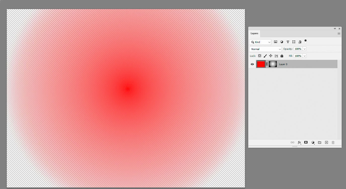

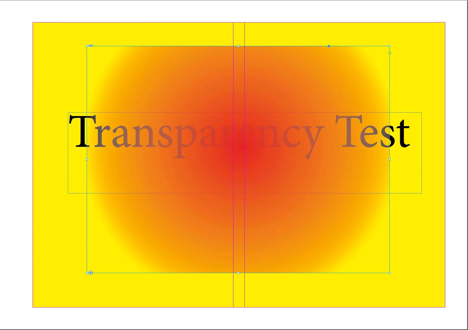

I’ve just exported a png with transparency checked using Export and placed it in InDesign where the transparency was used.
Photoshop :
Photoshop Export:
InDesign:
