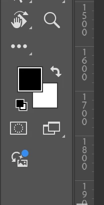

    Oct 1, 2024 5:05 AM UTC
    To anyone else that encounters this problem. make sure that your colour picker on the left. which sets foreground and background colour is set to black and white. Was battling this same issue for over an hour. Hope this helps.

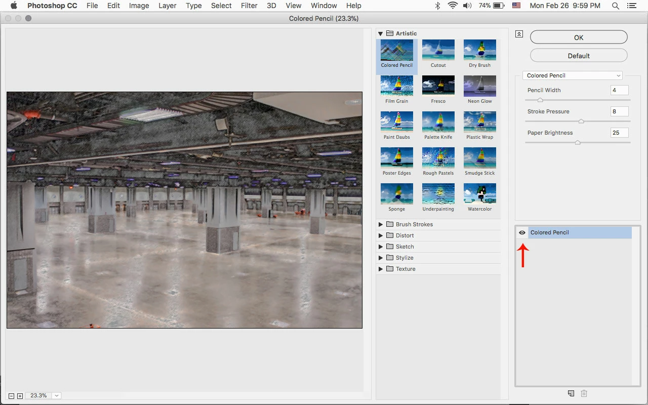

    Jeff Arola
    May 10, 2018 10:36 PM UTC
    A common problem is not having the Eye(s) enabled next to the effect(s).
    Pixel Territory
    Nov 12, 2019 12:39 PM UTC
    Thank you so much Jeff, this was great advice and worked for me. 🙂
