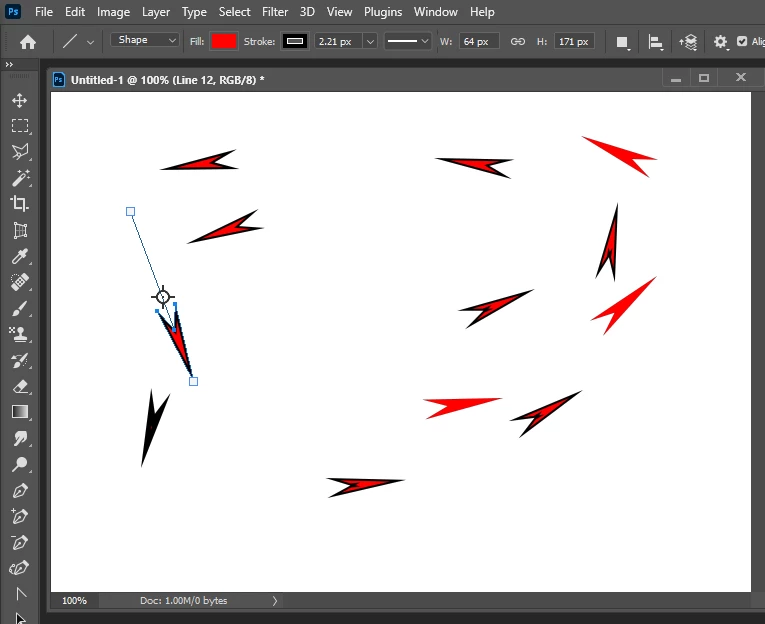

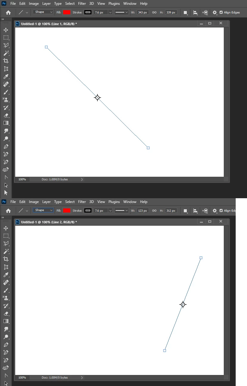

Adobe broke the line shape tool when they removed line weight. The Line Shape tool can only create arrowhead Shape layers. You have to use the rectangle shape tool to create line weight shape layers. Use both tool and merge the two shape layers to create shape layer with arrowheads you want. For if you Stroke the Arrow Shape Layers the arrow line stroke will be a 0x wide stroke line,  or a 1x wide stroke line or a 2x wide stroke line.  None of these will be the arrow shape layer you want. For only 0x wide line arrow layer arrowheads point to the correct location you do not an arrow shaft you have been shafted.

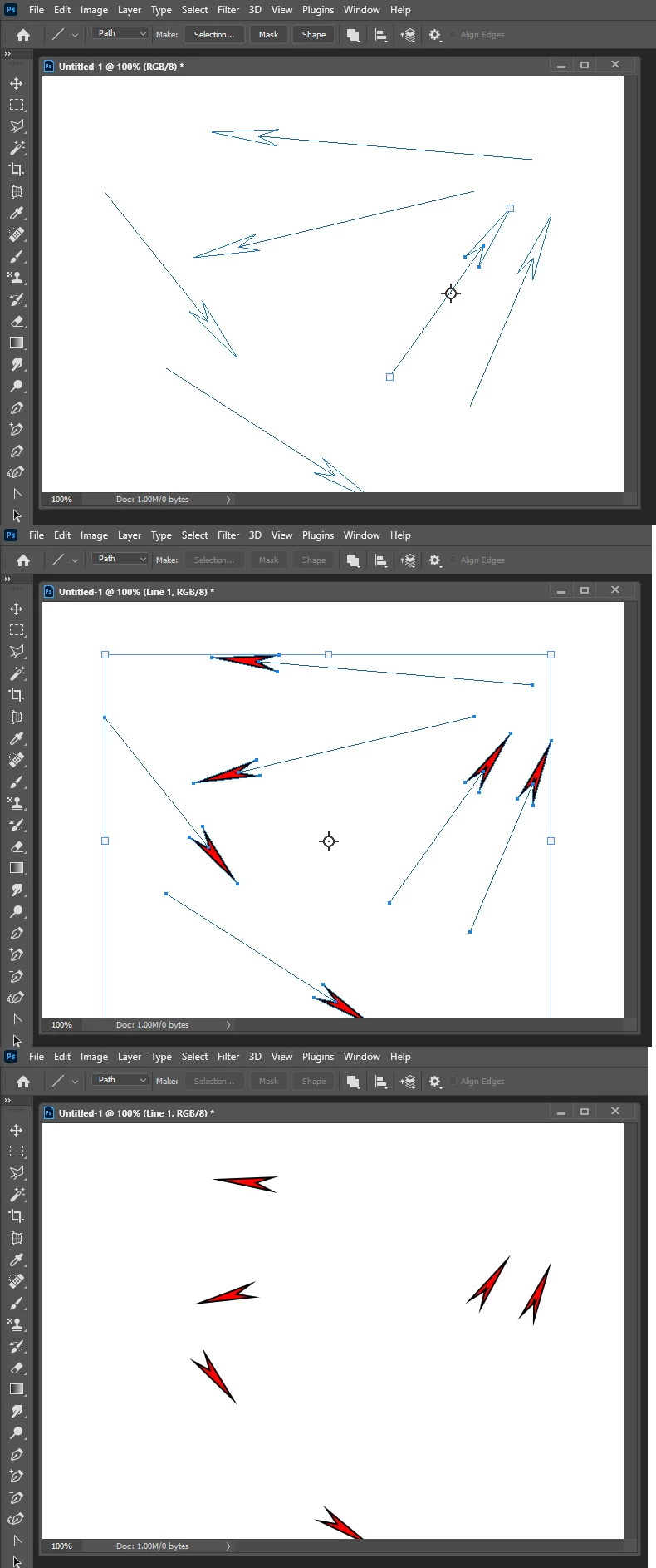

So a zero width path has no inside or outside for you have zero you have nothing there can be no inside or outside  or center.  The Reason the Line tool did nothing for me was Adobe installer migrated my Photoshop 2020 preferences  and my preference was set to stroke inside.   Adobe failed to realize a zero weight path has no inside center or outside.  Only the Paths can be stroked a setting stroke inside or outside would be invalid. Photoshop should have generated an error message. Instead Adobe bug bit my work.  If my setting was stroke centered or outside a stroke would have been laid down correctly or incorrectly.   Adobe 2021 Line tool has a problem.

This totally disrupts my work flows with Photoshop. I've rolled back to the 2020 version. I cannot understand who thought this was a good idea. Does Adobe talk to users still? The stroke option, described as the correct option by Sahil.Chawla has no effect for me if the path is not closed. Interesting that the support help section for shape tools is not even updated to describe the now broken function. It should not be marked as the Correct Answer. The correct answer would be something like, "Adobe realizes it have made a horrible mistake and will restore this feature in an update later this week. Please accept our most humble apology."

The Line tool in Photoshop 2021 is garbage.  Shape layer are fill layers with vector layer mask  when there is no line weight there is nothing  reveal in the fill layer and so there are  no pixels that can be stroked and the line shape tool does not stroke the line path.  So all the line tool shape option can produce are arrowheads shape layers line shape layer can  be created.  The Line path would reveal no pixels in the fill layer for the line path has no weight.   Line need to have weight  like the had in previous Photoshop  versions.  I'm quite sure all actions that added line may have been broken and may not be fixable.  Adobe does not seem to consider compatibility important they keep braking Photoshop not being compatible with previous version of photoshop is a serious problem for users work-flows are broken user assets are no longer compatible with  Photoshop.  It is very important to keep old version of Photoshop.  Do not let Adobe installer remove working versions of Photoshop.

It turns out because  Previous version of Photoshop the line tool has weight the acrions recorded are  good in in 2021.  You just can not record action actions in 2021 to create line shape layers because the Line tool in 2021 in shape node cans not seem to create shape layers. with strokes

Why does Adobe disrupt user work flows and lower their projectively  forcing more step to do something that was so easy.  The stroke option does not stroke path that are not closed just the arrow heads are stroked lines are not stroked not arrow head no line shape is stroked  the line tool can not draw lines  or line shapes.
no line strokes
Is it a bug that stroke line does not stroke?
