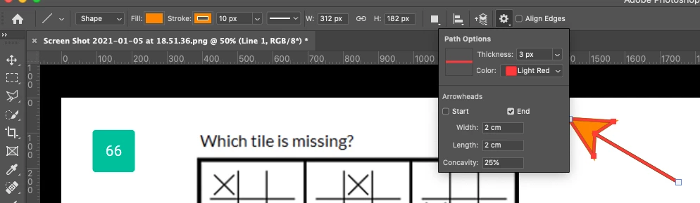

I use this for quickly annotating screenshots - paste, drop a couple of arrows on, then copy back out to Slack/email/etc. I can't figure out how to draw an arrow as a single step now. I've installed some arrow custom shapes which helps, but they're all oriented N/S/E/W, so I can't draw on an angle. The thickness etc. also changes based on the size so looks inconsistent and messy.
So how do I draw an arrow?
Convergnt

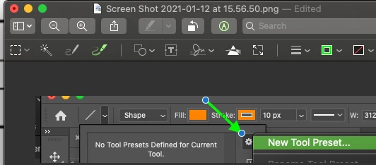

Jan 12, 2021 9:06 PM UTC
SpooNZ i think that may be one task that benefits from this vector line madness, if not in one-click:
the arrow option is under the Gear icon. Once you've formatted the arrow the way you like, you can save it as a preset for quick use the next time.
I still find this tool to be a battle.

KazVorpal
Jan 15, 2021 12:25 AM UTC
Saving as a preset is still more trouble than being able to set it as a percentage.
Losing that is an idiotic problem that we haven't emphasized enough on here.
