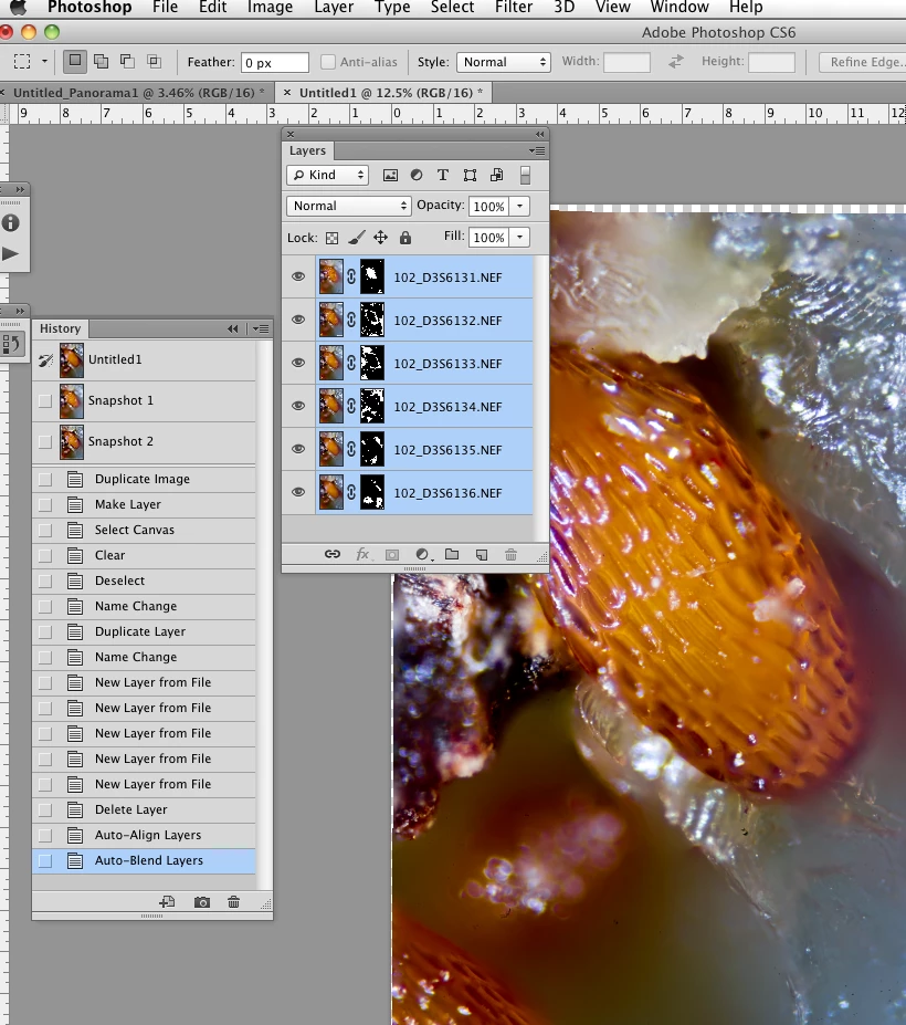

    It seems as if Photomerge when used for Focus Stacking is partially broken in CS6.
    If I select images in Bridge and use Tools/Photoshop/ Photomerge, I do get a stack of Layers but the images do NOT auto-align.
    However, if I choose Bridge/Tools/Photoshop/Load Files into Photoshop Layers;
    then, in Photoshop: use Auto Align followed by Auto Blend, I do get a Stack with appropriate Masking.
    Photomerge seems to be missing the AutoBlend Layers Panel and the  "Blend Method/Stack Images" checkbox which you get when you do the Stacking in Photoshop one step at a time.

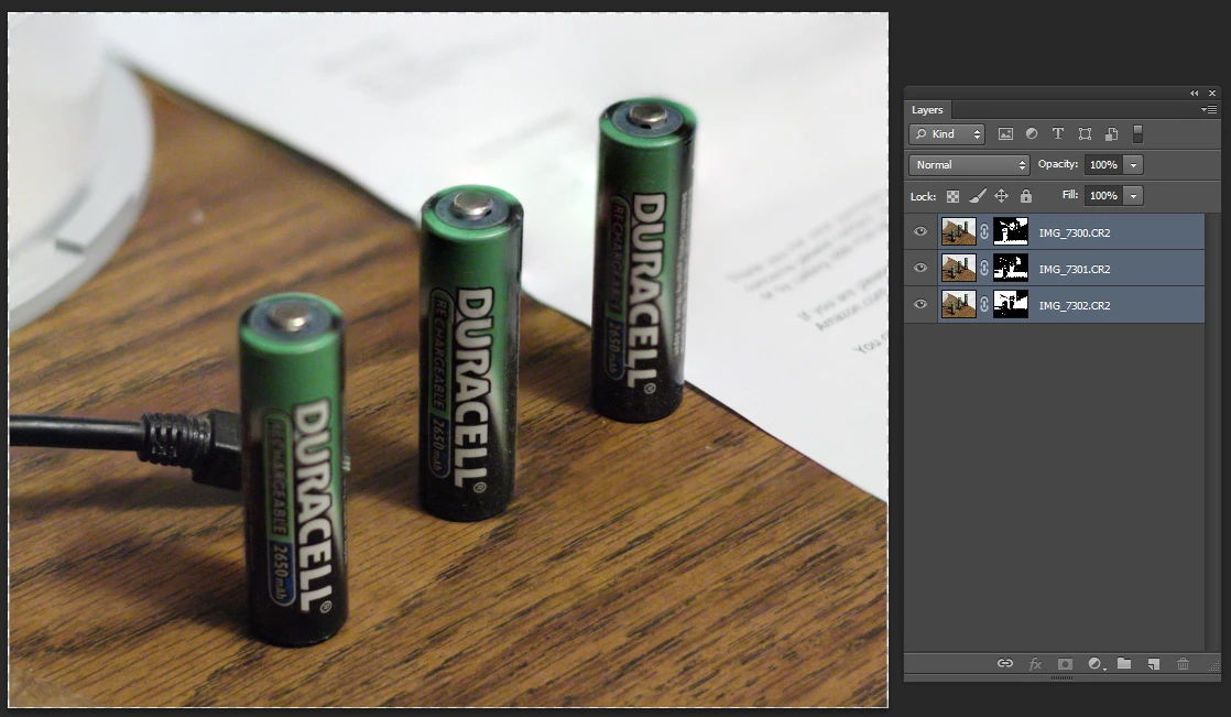

    June 24, 2012
    By the way, I just completed a focus stacking operation (starting with Load Files into Stack, then Auto Blend Layers) with 3 small test images and it seemed to work flawlessly:
    -Noel
