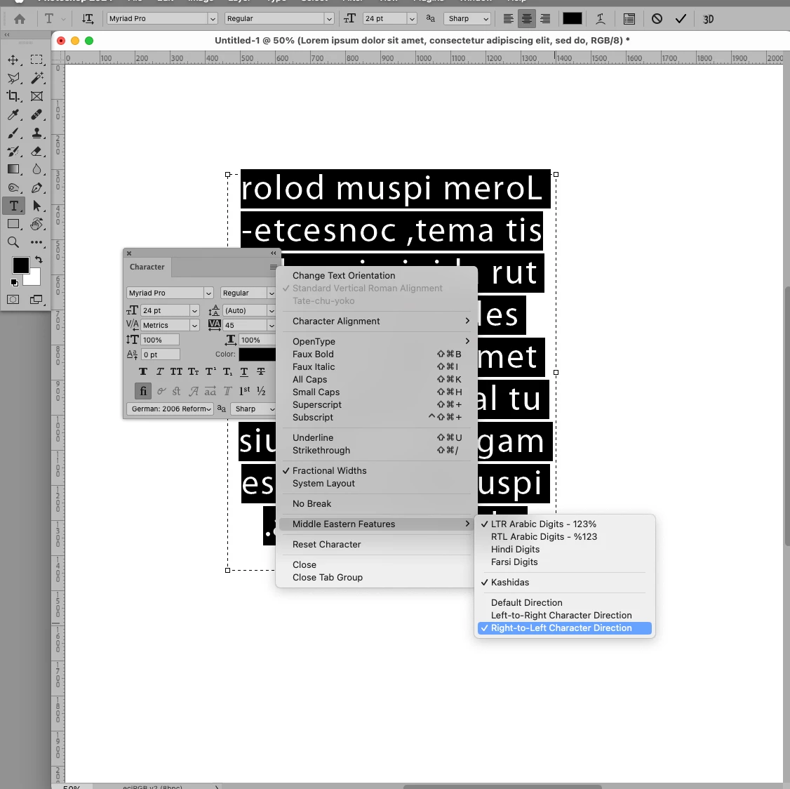

Please provide the file or at the very least meaningful screenshots with all pertinent Panels visible.
Is this about the Character Direction?

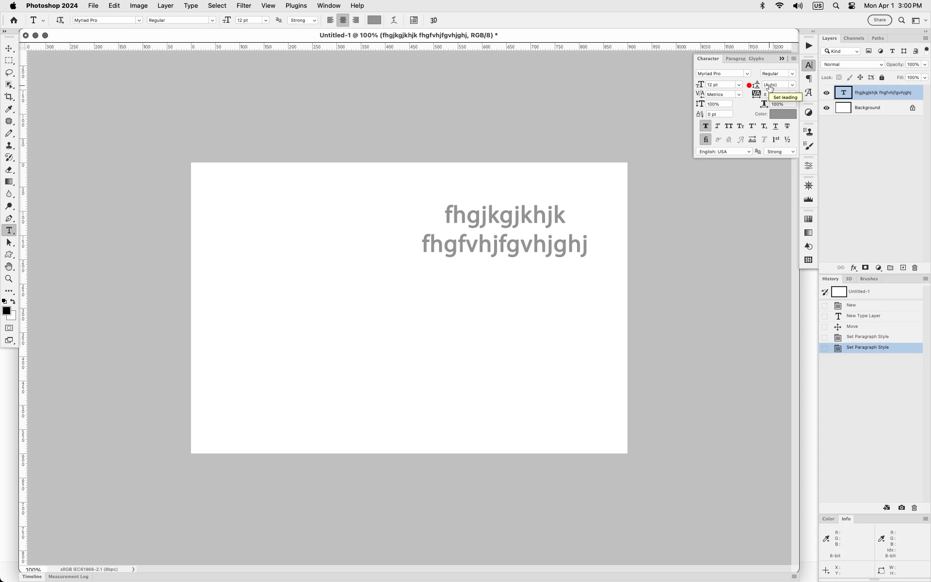

Look at Leading in the Character panel
(Window>Character)
Try the Auto setting

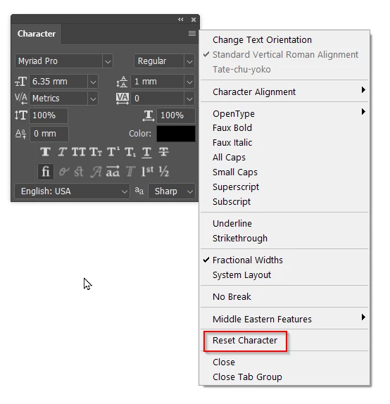

Trevor.Dennis
April 2, 2024
I did wonder iif Resetting the Type tool would return the Character panel toits defualts, but I just etsted and it doesn't happen.  You have to reset each parameter individually, or you can reset the panel from its drop down menu
