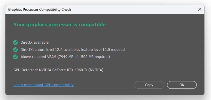

Freezing/out of memory issues when using "Filter --> Camera Raw Filter --> Presets"
Hi.
The below issue has been happening for a while. Yesterday for example, I freshly re-installed Windows 11 again along with my Adobe products and it happened on first try.
In Photoshop, when using Filter --> Camera Raw Filter --> Presets,Photoshop will freeze or sometimes display an our of memory error.)
  • Does not matter if I disable onboard GPU.
  • I'm using studio driver. Game driver made no difference either.
  • All drivers updated.

Sep 28, 2025 6:59 PM UTC
I would definitely try to disable the integrated GPU. Instructions here:
https://helpx.adobe.com/photoshop/kb/troubleshoot-gpu-graphics-card.html
But you should also try a complete reset of preferences. That has fixed similar issues for other users. The preferences contain the whole application configuration; not just your own user settings. Corrupt preferences tend to look like application bugs.
Go into your user account and move the whole Photoshop Settings folder to your desktop (for backup). This reverts the application to clean factory state. Ignore the two first methods here and go right to the third:
https://helpx.adobe.com/photoshop/using/preferences.html#reset-preferences
Rachael87Author
Sep 29, 2025 4:05 PM UTC
Thanks for the suggestions. Both have been tried a few times before with no success.
It even happens on a fresh install of Windows 11 and Photoshop, so no preferences would have even been changed.
Claire H.
Sep 29, 2025 10:44 PM UTC
Hi @Rachael87, Let's try a few other things to get you back to a smooth editing experience. Since the issue occurs when using Camera Raw Filter > Presets and persists even after a clean OS and app reinstall, here are a few additional steps to try:
1. Disable GPU in Camera Raw: Go to Edit > Preferences > Camera Raw > Performance and set “Use Graphics Processor” to Off.
2. Adjust Memory & Scratch Disk Settings: Lower Photoshop’s memory usage from 70% to around 60%. Here's some more information about Scratch Disks: https://adobe.ly/3KNxtO4
3. Run Photoshop as Administrator: Right-click the shortcut and choose “Run as administrator.”
4. Test in a New Windows User Profile: Create a new user account and test Photoshop there to rule out profile-specific issues.
Let's try these things first and see if it fixes your issue. I hope this helps! ^CH
