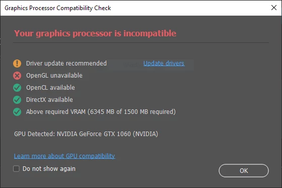

Hi Jeffrey, thanks for your response. After following your steps, I think I've found the problem - it seems to be related to the dock I am using for my additional monitors (see https://community.adobe.com/t5/photoshop-ecosystem-discussions/opengl-unavailable-after-update-to-photoshop-2022/td-p/12502620). The workaround is to set my laptop screen as the main display (or disconnect the dock while loading Photoshop, then reconnect. Both are workarounds I can live with.
To respond to your questions - re: the crash report, Photoshop has never generated the Crash Reporter dialogue, it's simply stopped loading during startup. I checked the registry and Never Ask is set to 0.
Disabling the Spaces plugin allowed Photoshop to open. Prior to making my laptop screen my main display, I was then presented with this window saying my graphics processor is incompatible. I tried reinstalling the latest drivers from NVIDIA (Studio Driver Version 472.84) but this didn't help. This problem has since gone away and I was able to re-enable the Spaces plugin.
Thanks for your help!!
