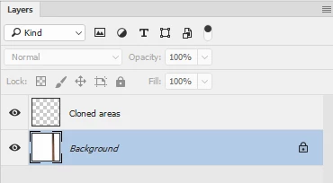

Correct answer davescm
Assuming
that you want to keep the vertical object, that is a simple cloning job.
Select the vertical object, and invert the selection so that everything except the object is selected. This will stop the clone tool acting on the wanted area. Note - my selection is on the vertical object - those other "marching ants" are your screenshot not my selection.
Add a new empty layer.
Select the clone stamp tool and, in the options bar,  set sample to "Current and below"
Alt click in the white area move your cursor vertically down  paint into the area below. You are painting the clone onto the new layer and are restricted by the selection so that you don't paint on the wanted object.
Note -I then inverted the selection and painted out the marching ants from your screenshot that still covered your wanted object.
I hope that helps
Dave

davescmCommunity ExpertCorrect answer
March 4, 2017
Assuming
I hope that helps
Dave

davescm
March 4, 2017
Can you post an example of what you are trying to patch. There are several ways to approach cloning and patching - including copying areas onto a separate layer to patch/clone, restricting the cloning with selections, using vanishing point to resize cloned area as it is moved etc .
You can also do what you describe with a duplicate layer and a mask. Mask out the area you want to replace then move a duplicate underneath till it matches.
The best way just depends on the image.
Dave
