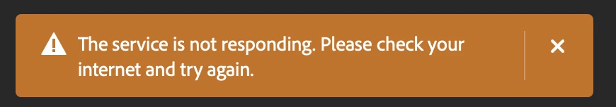

Hi there,
I've been getting this error message "The service is not responding. Please check your internet and try again" constantly since last week. It was working perfectly before then on the beta version. I've tried deleting the beta version and work with Photoshop v25.0 which has generative ai function but keep getting stuck at 100%. On top of that, it seems to work randomly when I connect to my phone's hotspot but it fails again after a few minutes. I'm on a mac and I've tried to disable the firewall as suggested by some people but still doesn't seem to work.
Any ideas would be appreciated. Thanks!

For anyone else coming across this: I worked with Adobe support and found that the issue was due to DNS resolution failing for specific hosts. The short list of hosts they gave me to test related to generative AI tools are:
firefly.adobe.io
firefly-clio-imaging.adobe.io
*.ff.adobe.io (highly critical wildcard domain covering feature-specific endpoints such as:)
  di-me.ff.adobe.io (Generative Fill/Expand image upload)
  upsampler-v1.ff.adobe.io (Generative Upscale)
  di-imaging.ff.adobe.io (Select Subject and Object Imaging)
  di-imaging-genharm. ff.adobe.io (AI Harmonization)
  filix3.ff.adobe.io
I happened to be using Fortinet’s DNS servers, which weren’t resolving anything but the first entry on that list.  I changed my DNS server to 1.1.1.1, which worked around the issue.  This also explains why turning on a VPN fixes it - Doing so typically overrides your DNS server with one from the VPN provider.
Make sure you can nslookup and ping each of the above hosts. If you can’t, change your network’s DNS server.
