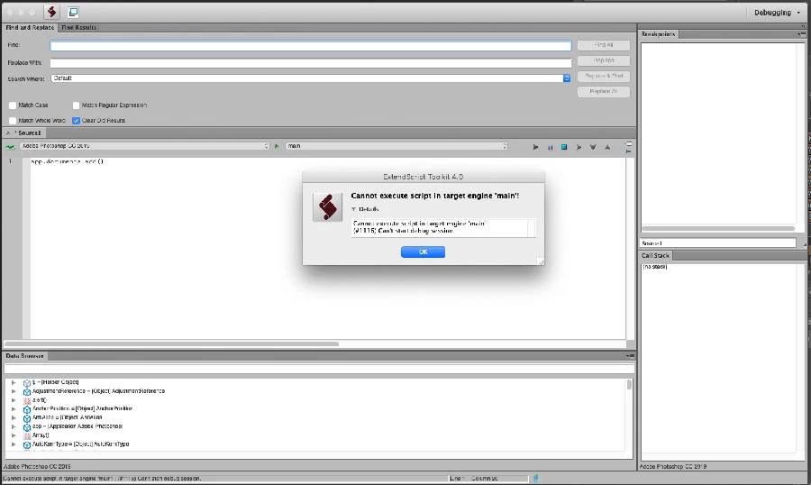

I wanted to experiment writing some Photoshop scripts so I downloaded ExtendScript, created a couple of very simple scripts, saved them to the script location and verified that they actually ran. Once I verified that the pieces all worked (ie, ExtendScript was properly installed, I knew where to place the scripts and how to call them) I decided to write something more involved, and that meant that I wanted to run the scripts from ExtendScript rather than create a script, copy it to the scripting location and running it through Photoshop, and that is where I ran into some issues.
I opened Photoshop, opened ExtendScript, opened the scripting documentation that came with ExtendScript and created the first single line script in the document - app.documents.add(), and pressed Run. I got an error. -
Cannot execute script in target engine 'main'!
(#1116) Can't start debug session.
It seems clear to me that I am missing something fairly basic. The ExtendScript app is set to Photoshop and main, but will not run even a simple one statement script without an error, so something pretty basic must be wrong. Interestingly enough it (sometimes) actually created the document, sometimes did not, but always gave the error, even when the document was created.
Hence this post and a couple of very basic questions:
1) What do I have to do to get a script in ExtendScript to run? What settings are wrong in the app?
2) Is there a basic starting guide to explain how to use ExtendScript as a debugging tool? If so, where? As I mentioned I was following the instructions in the Adobe Introduction To Scripting document word for word and still got this error.
3) Can regular javascript and the Adobe version be mixed seamlessly in a single script (or multiple script libraries) so that a script can control both Photoshop and other non-Adobe applications on a system? Or do I have to create different scripts for Photoshop and OSX usage (I am working on a Mac)?
Thanks for any help.
Correct answer Manan Joshi
Seems you have run into an issue that has been discussed in the following thread.
Extendscript Toolkit debugger fails on Mac: Can't start debug session
Try the solution proposed and see it resolves your problem. You could also try the VSCode extension mentioned in this thread.
As regards using extendscript with JS for non Adobe application, one way is that you can mix platform specific scripting like Applescript on MAC and VBScript on Win to automate other non Adobe applications. Look into the doScript method of application. However you won't be able to directly access the functionality exposed by other application into your JSX code.
-Manan

Manan JoshiCommunity ExpertCorrect answer
March 31, 2019
-Manan
-Manan
March 31, 2019
Thanks for the link. I did a search before I posted, but did not see that, but changing the value does seem to have fixed the issue. The thread referred to the 18 November 2018 date, but apparently the issue exists beyond that date as well. Seems a bit of a surprise that Adobe has not fixed this issue.
In my particular case I was investigating the idea of allowing Photoshop to call an external tool that is not a plugin, wait for the tool to complete and then reload the image. That would require that I (1) save the image as a temp file, (2) start the other app with the image as a parameter, (3) wait for the app to complete and then (4) reload the image. An acquaintance asked me if this was possible and I decided to use it as an excuse for learning some javascript.
Items (2) and (3) would require OSX coding to launch the app and wait for its exit and update of the file, and thus presumably would be javascript (or AppleScript or vbscript). Since ExtendScript is the Adobe stuff I assumed that either I could also write javascript in ExtendScript or call a separate js script, but am not familiar with the toolkit or, for that matter, javascript itself, although I used to write java code so I assume javascript should be closely related to it and relatively easy to pick up.
Again, thank you for the link.
