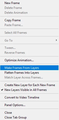

I am trying to create a gif, I have followedAdobe's tutorial, but I am stumped at Step 3.
While I am supposed to click on the "make frames from layers", I cannot find this option on my menu of PS CC.
I get this instead :
What to do so I can proceed?
Thank you very much

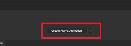

Yeah, you see where it says "Create Frame Animation" - click that.

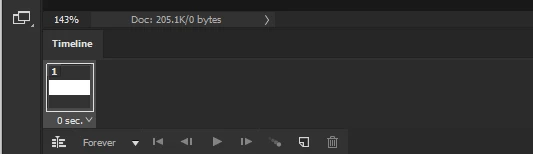

Hi! I just had the same problem. Once you picked frame animation, select 'frame animation'  AGAIN which will automatically open the timeline with your first layer, and then you should have the option to create frames from layers. Hope this helps someone, I know I am replying to an older post, but this is for all of those struggling now! 🙂

Also, just to make sure. When you select "Frame Animation" from the drop down... Have you pressed the actual "Create Frame Animation" button to the left of the triangle as highlighted in Ged's screenshot?

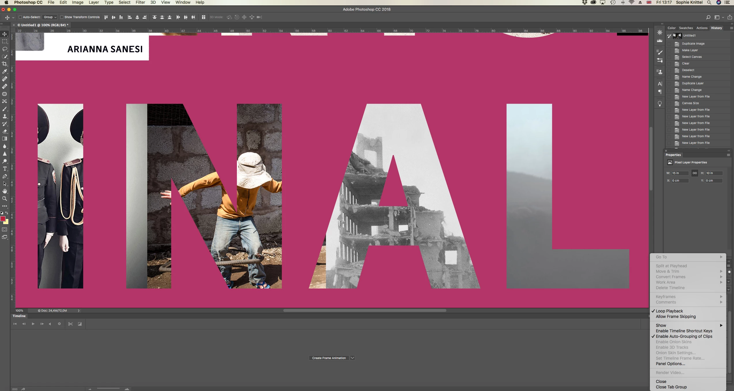

Here is the full screenshot. All seem normal but for the menu.
My Photoshop version is up to date, so I don't understand.

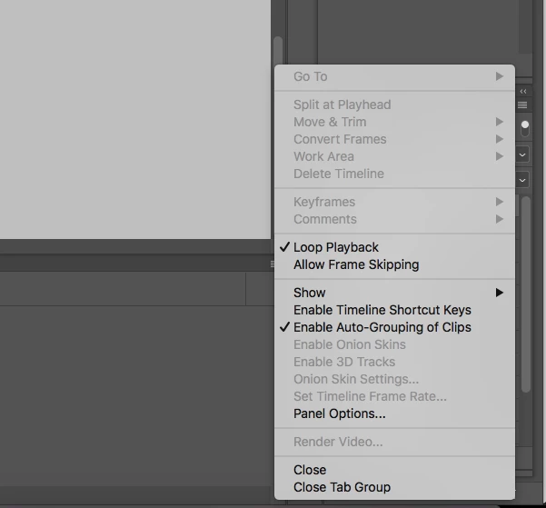

Your menu is the menu for "Video Timeline" instead of "Frame Animation" which is why I suggested deleting the timeline.
If you have followed the steps above, it could be a bug. I would suggest first restarting Photoshop.

October 12, 2018
I managed to figure out your issue. (I think!)
Click on the timeline > then select > delete timeline > then when you see the below, hit the arrow and press "create frame animation"
Hope that helps.

make sure you have all layers highlighted, then it not greyed out.
