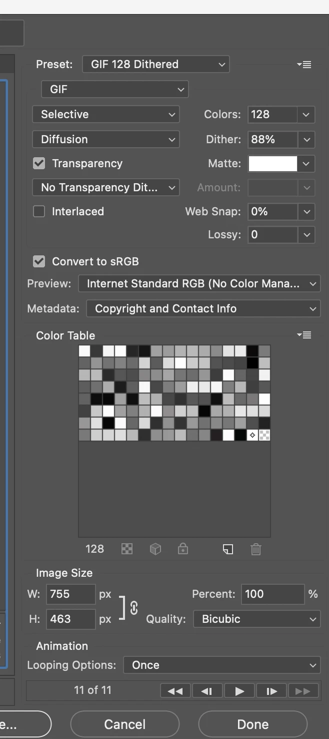

    November 24, 2021
    I'm not sure why but I was having the same problem. Plays fine in PS and at the save for web menu. But after exporting the Gif wounldn't play. Now I've made animations before but this one wouldn't work.
    Then I exported again and the only thing different was I hit the play button just above the the "D" in DONE at the bottom of export menu (see image). Not sure if that's what did it but when I exported after that it worked wonderfully in a browser and my finder menu as well.

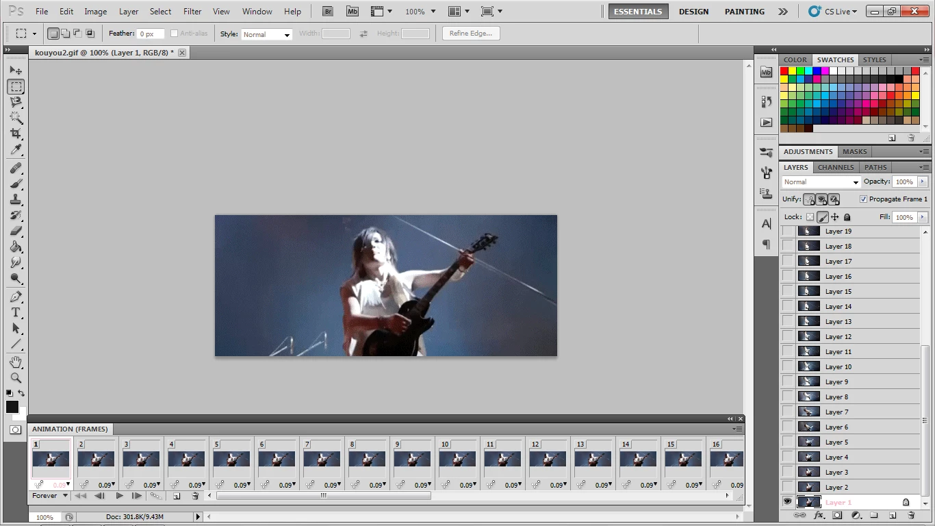

    September 29, 2018
    In case "manually adjust the length each image stays on the screen for" was vague I've included an "After" pic of the same file as posted previously, as well as the outcome.

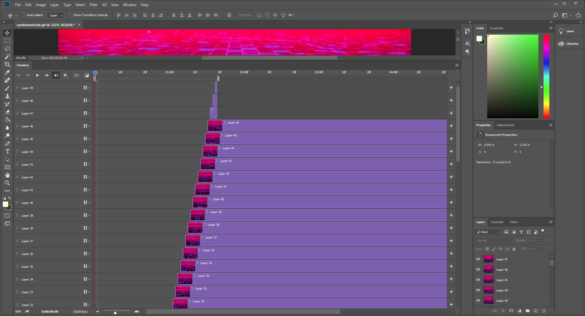

    September 29, 2018
    I've been having the same problem. I opened the timeline, and I found that photoshop on defaults to making gifs where each image plays for the entire length, resulting in a gif that "plays" but only shows the bottom image. (See attached photo.) The only real solution kinda sucks, but you have to manually adjust the length each image stays on the screen for. This really SHOULD be considered a bug, and the fact that it hasn't been fixed is making me reconsider my subscription. Also, Noel, this is NOT a user error. You shouldn't be BSing around accusing people of corrupting files just because you can't admit you don't have a clue what you're talking about, "Photoshop Expert."
