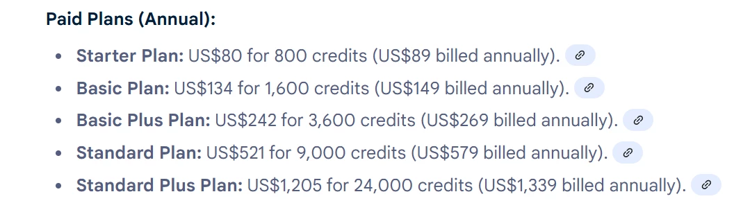

This is a bit late, but have you found Evoto?  I just used it to remove glare from my subject's glasses, and it WORKED with a click of a button.

Jun 4, 2025 11:15 PM UTC
Wow, that's a lot of money for just one app.  If I am understanding this correctly, it cost twice as much for a single application, than the entire Adobe CC subscription.  That can't be right. Are they all fully functional, and it's just the number of images you can edit that controls the cost?
