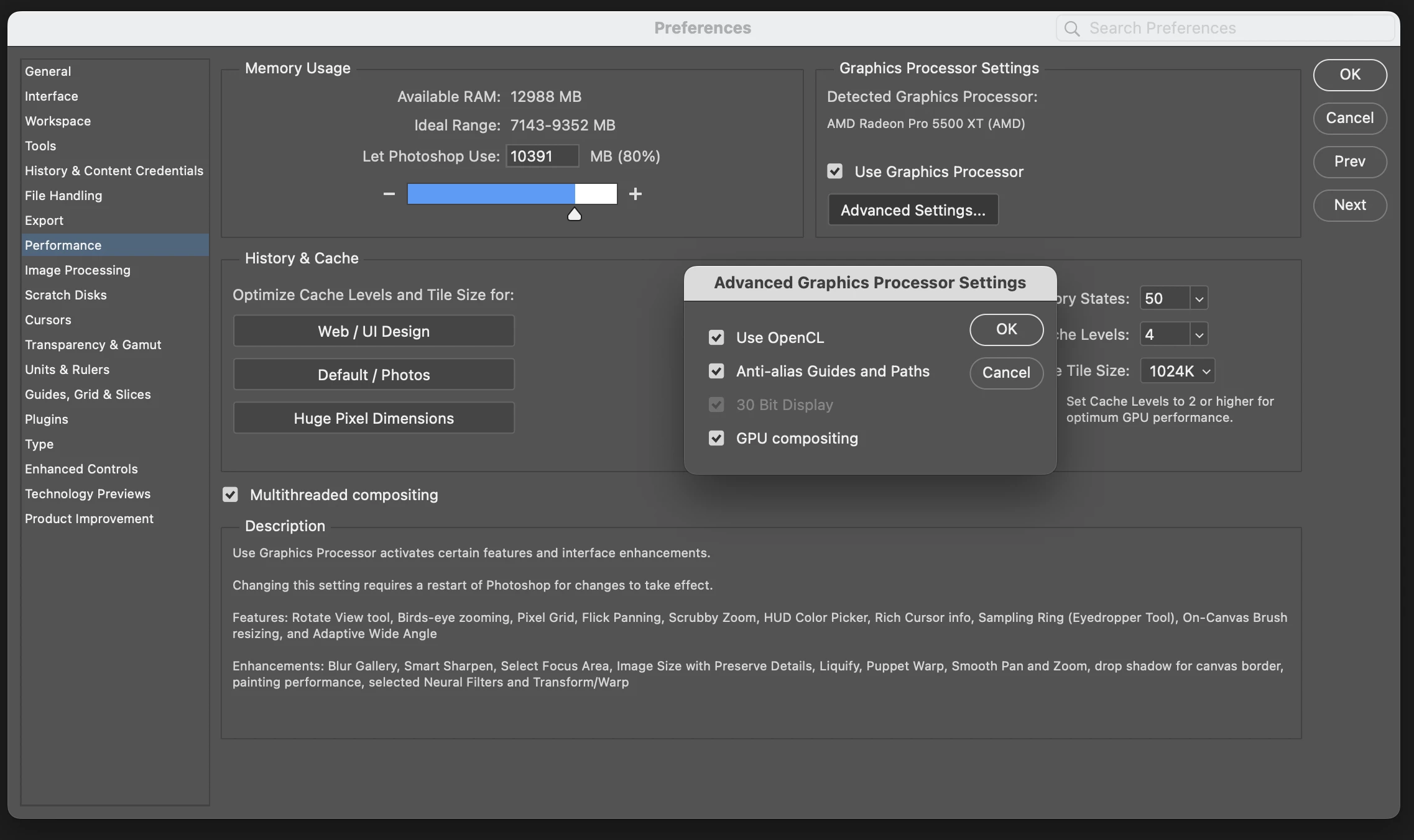

Hi Running a Imac with Sequoia 15.2.
Processor - 3.8 GHz 8-Core Intel Core i7
Graphics - AMD Radeon Pro 5500 XT 8 GB
 16 GB general RAM.

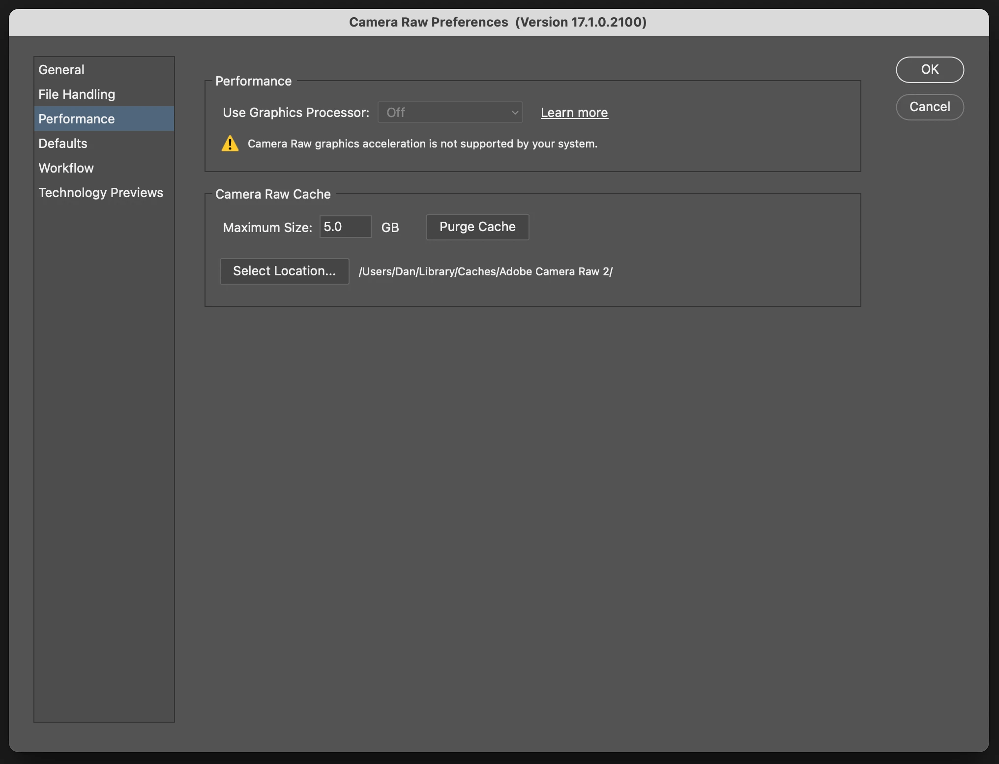

Problem: When opening a new RAW or Jpg in PS RAW filter is not available. Looking under Setting/camera Raw/Performance I see GPU is turned off. Underneath dialogue box indiction that "Raw graphics acceleration is not supported by your system"
Graphic accelleration though is supported in Lightroom. (also very much up to date) This is just a PS glitch. It was working just fine and then it wasn't. I hit no switches

- Under PS settings/Performance (preferences) I have unclicked "use graphic processor" - restarted PS and found RAW filter still not on. Did not switch to regular RAM. Reclicked 'Use graphic processor' box
- Under PS/Settings/Performance 'Advanced' I uncliked 'Use Open CL', restarted PS to no avail. Still GPU was turned off.
- Under PS Settings/Preferences/Performance, increased available RAM from 70% tp 80%

Answer found. Problem solved. Tried rolling back camera raw. It half-worked. Installed camera raw 17.1 over PS 26.2. RAW filter is back.

It worked and then it didn't? Probably due to opening a file that taxed the GPU.

It worked and then it didn't. Nothing different with files I was opening.
Suffice it to say my GPU is compatible.
