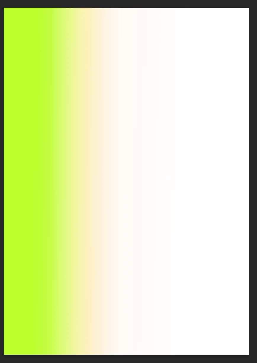

I would like to create a print of a gradient effect however engineer the colour lengths.  So, to determine the individual colours lengths by making them wider or narrower.  It will be used to place into pattern pieces for clothing items (so you can imagine if for a floor length dress you want a particular colour say over the waist and then another colour for the skirt - the waist colour will be shorter in length than the skirt colour - attached 2 example images).
The gradient tool in Photoshop doesn't allow for this precision so I'm thinking each colour has to be created individually using separate layers and then blurring the ends to create the gradient effect?  This way you can widen or narrow the specific colour and therefore the gradient is engineered to your determined measurements.

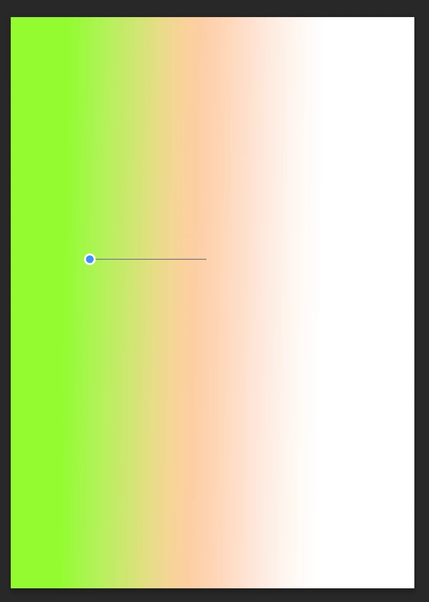

I've also attached an example using the gradient tool but it doesn't work and just 'overirdes' the colours every time I go over it.
Would anyone know if by using layers as a method is the best way to approach the project?
Any other tips would be great (how to blur the ends, avoid bars and to create very smooth gradient transitions from one colour to another?

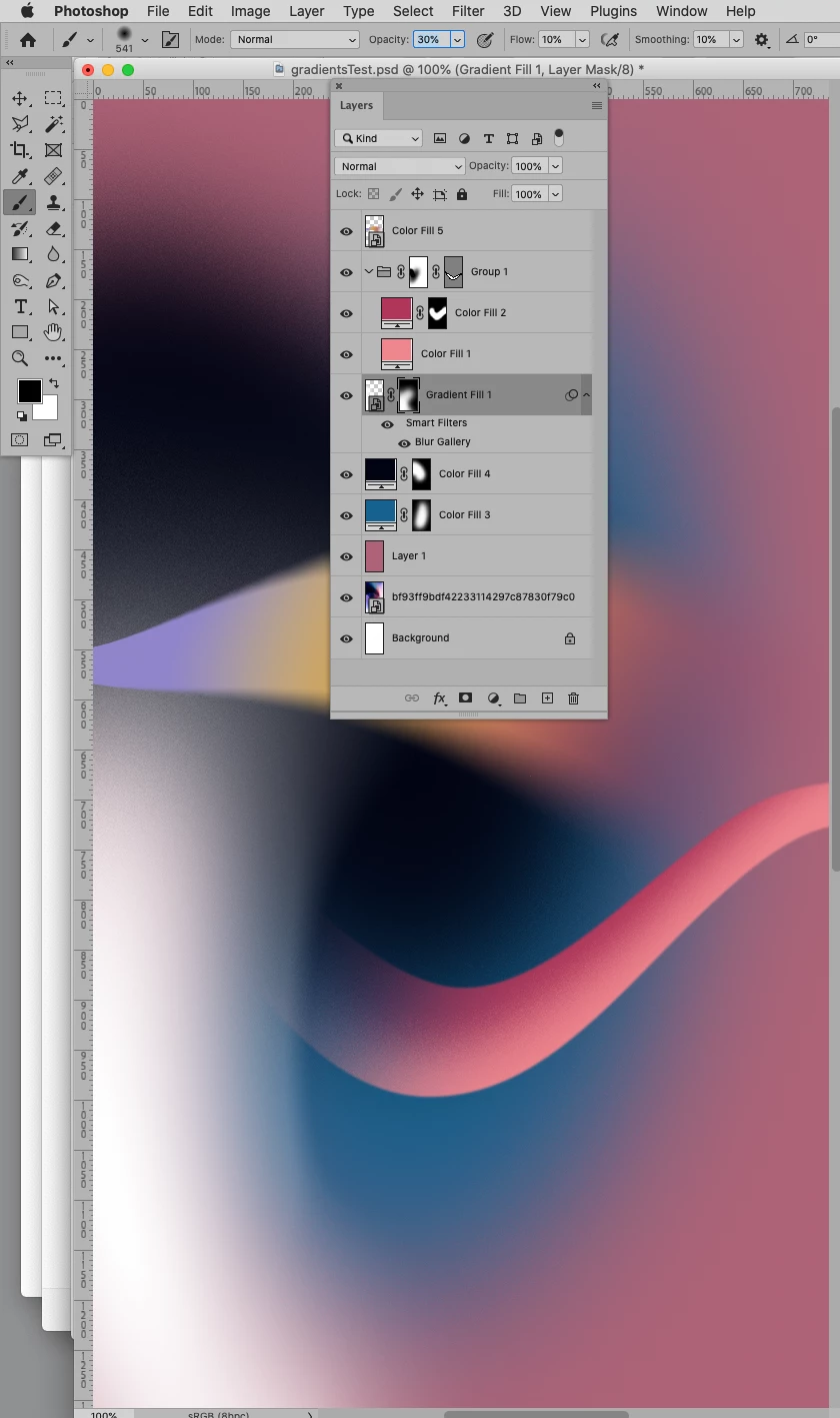

2nd Question:  I've also attached more of a complicated abstract gradient image.  What do you think the method/aproach would be to create something like this (line graphic then layer upon layer of colouring and bluring?)  Just trying to understand how it's done!
I would guess Solid Color Layers, Gradient Layers, Vector Masks, Layer Masks, Smart Objects, Blur Gallery, …
Ultimately a lot of manual painting may be hard to avoid.
