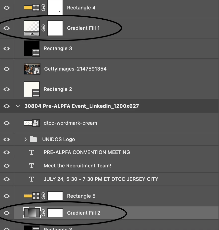

Hi, can anyone help me? I created a couple of artboards in different sizes, one for LinkedIn and one for Instagram. I am usung the same design for both and just re-arranging the elements as the sizes are very different, and I came up with an issue.
On the first artboard I created a a simple gradient, but when I copy it to the second artboard, it looks fine, I adjust it as needed but when I export both artboards to PNG, then the secon artboard's gradient looks really bad and not as it should lok.
I did noticed however that the icon on the layer from the gradient on artboard 1 looks different than the one on the layer on artboard 2 as you can see in the attached files, and I have a suspicion that it might be why I am getting different results when exporting. I deleted the gradient from layer 2 and make a new one and the icon still looks like the attached (Bottom, circled). No matter what I do, I can't get to have the same gradient Icon as the circled, top and hence exporting is causing issues. Can anyone please explain what is going on, and how can I fix this simple gradient issue? I will really appreciate it!! I have searched online and I can't seem to find the answer I am looking for. Many thanks!!!!

Just convert the Gradient to a Smart Object and use instances of that.
