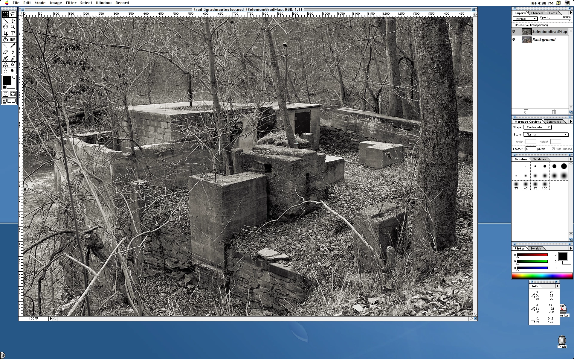

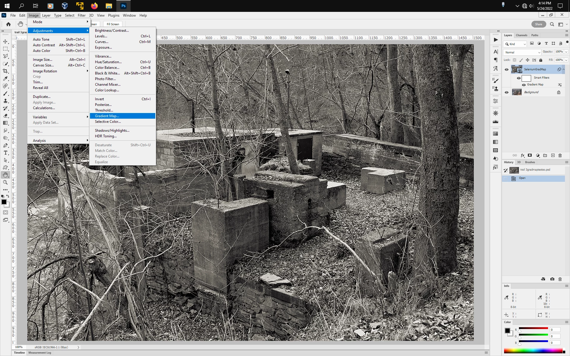

As far the Gradient Map Adjustment Layer in photoshop 2022, you can instead convert your layer to a Smart Object, then apply Image>Adjustments>Gradient Map as a Smart Filter using the Classic setting and users with photoshop versions as far back a cc 2015 should be able to modify the Gradient Map. Earlier photoshop versions will open the Gradient Map layer as a  separate flattened layer with the Gradient Map Adjust intact or as a non editable smart filter layer.
same psd opened in photoshop 3.0.5 creates a flattened layer with the adjustment intact
