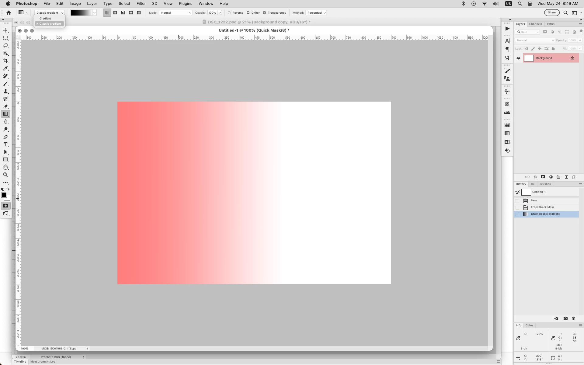

In the latest update to PhotoShop and the Beta version, I noticed that gradient masks are no longer working like they used to (again). It's one of PhotoShop's most powerful tools, and I am incredibly frustrated that this is being tampered with. Please tell me if this can be fixed or if I need to learn a new workaround for selecting with gradients in quick mask mode.

With the Gradient Tool selected enable Classic Gradient in the tool options bar before using in the Quick Mask Mode.

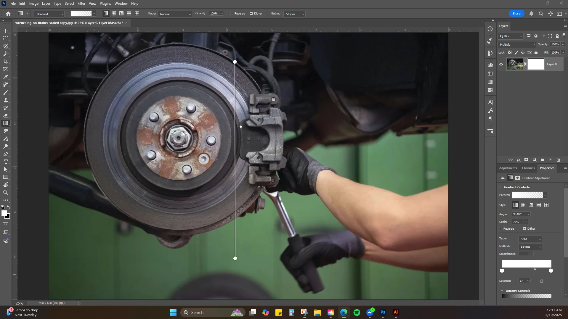

The foreground to transparent setting is not working when I apply a layer mask on my computer. But I can do this technique on my work computer. What gives?

My apologies - I selected the wrong "classic gradient" - there are two in the menu bar! I looked closer at your uploaded image and found the option. THANK YOU SO MUCH! This is what I needed. 👏
