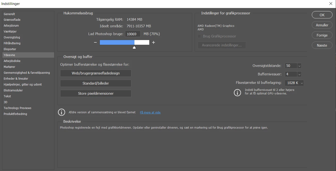

Suddenly my brush started lagging, and after some search I found that Photoshop couldn't detect my graphics card.
(it's in Danish but you can see how the field is greyed out)
What I have tried so far
I re-installed my graphics card and have made sure I have the newest version. It did not solve the problem. I have tried uninstalling and then reinstalling both Photoshop and Creative Cloud. That didn't help either (though it is lagging a bit less than before). I tried to move the sniffer.exe file, that did not help. I do not have dual graphic cards as far as I can figure out. I have tried setting my graphic card to top performance, that didn't help either.

Apr 21, 2021 9:07 PM UTC
You do not have enough VRam to use this graphics card with Photoshop.
From your system text: "
HasSufficientRAM: 0
VRAM: 520 MB
Required VRAM: 1,500 MB
Apr 21, 2021 9:29 PM UTC
Ah, I see... That's unfortunate... Thank you for your answer.
The only thing that makes me confused then is that Photoshop has worked quite well for me the past 6 months on this device, it just suddenly became a problem yesterday. Shouldn't it have been a problem from the start then?
