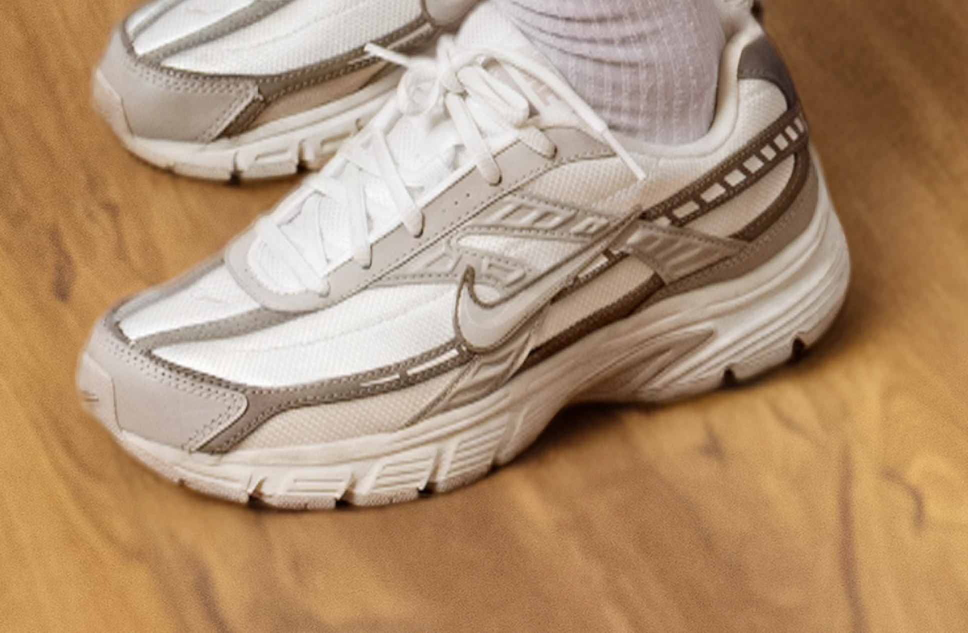

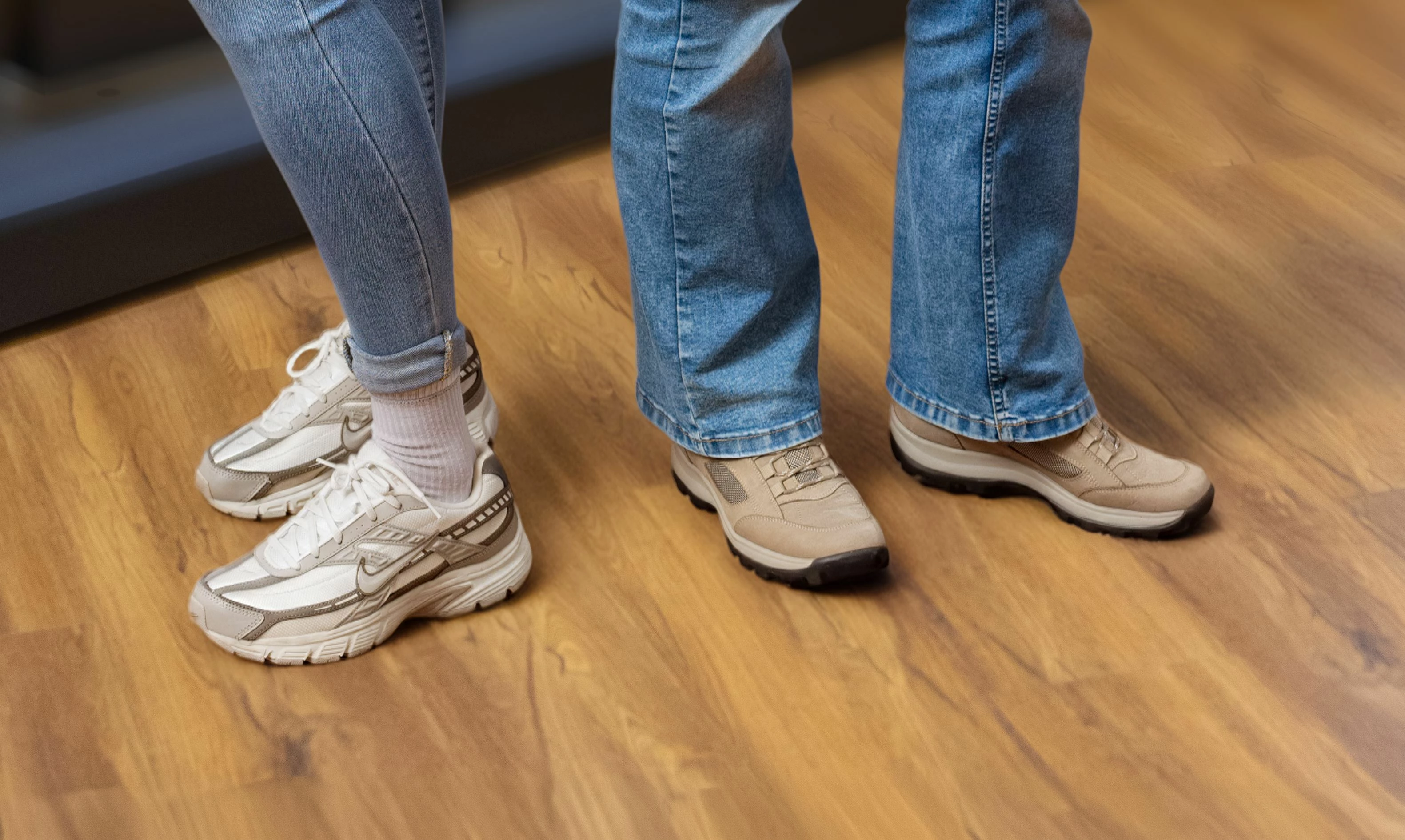

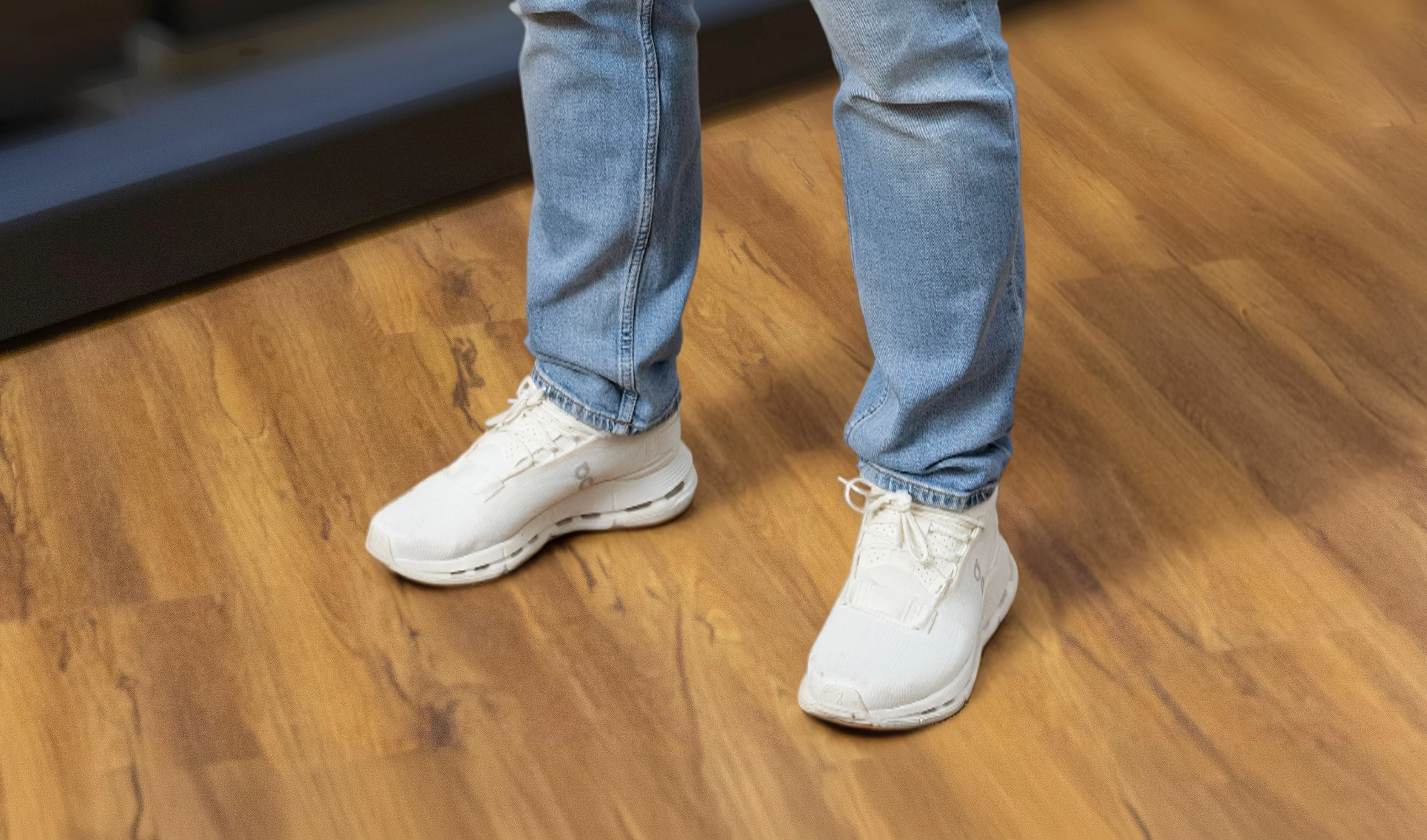

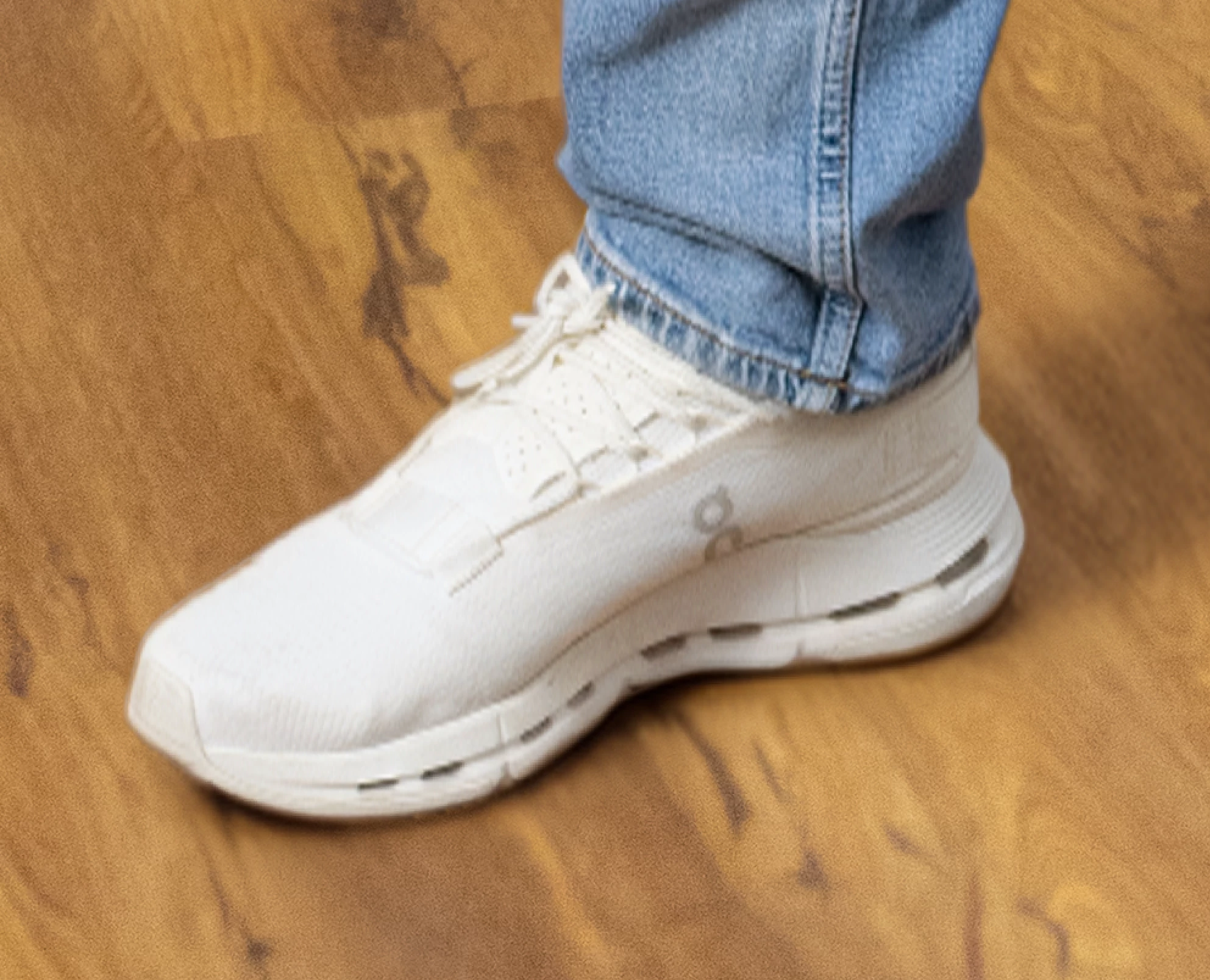

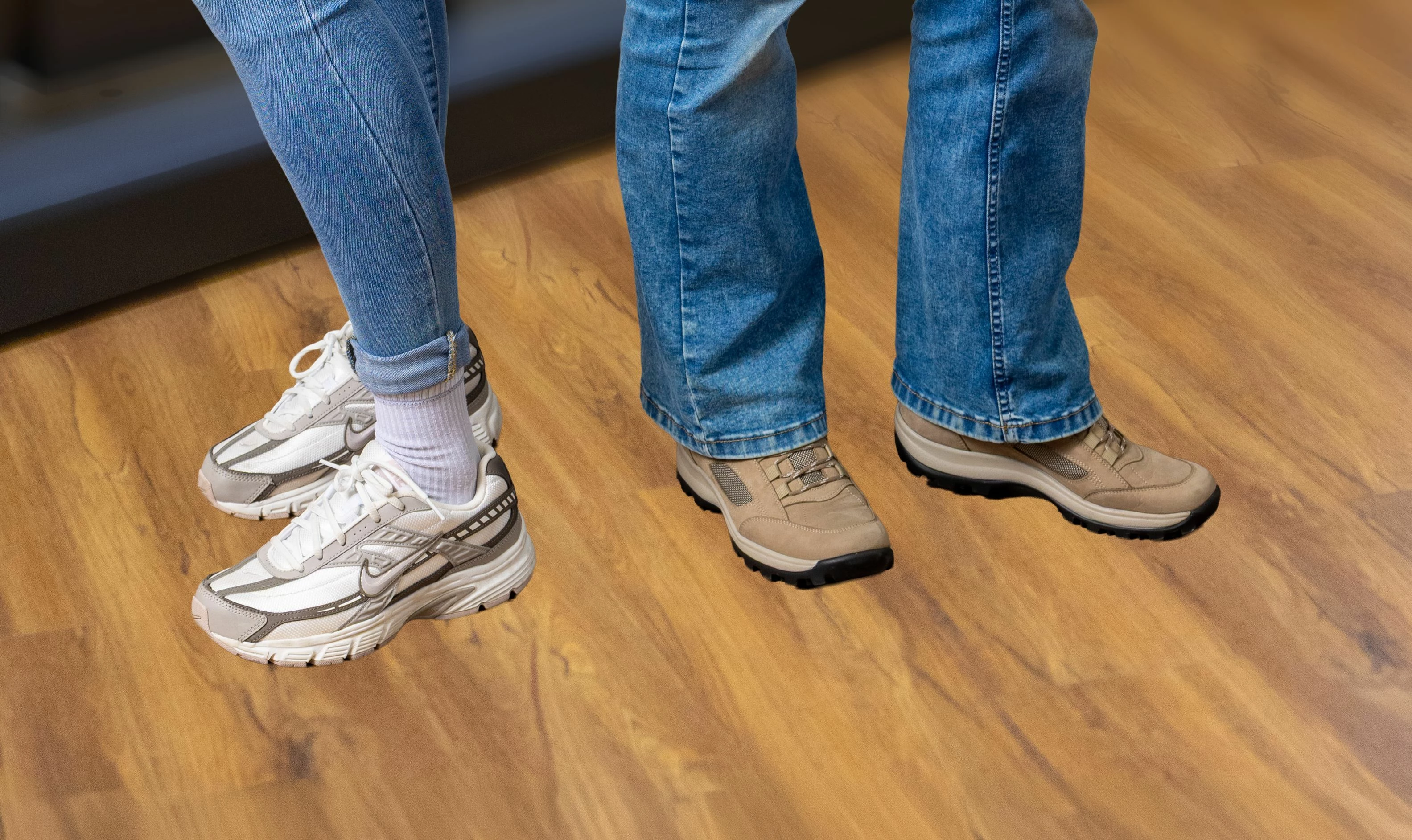

    Oct 4, 2026 4:13 PM UTC
    ​@c.pfaffenbichler c.pfaffen Sure!
    Here before and after using Harmonize, and thrid screenshots shows the lower resolution
    Without Harmonize
    When harmonization works successfully.
    Oct 4, 2026 4:15 PM UTC
    Crops, both with harmonize:
    c.pfaffenbichler
    Oct 4, 2026 4:22 PM UTC
    Please post more meaningful before- and after-screenshots that clearly show the actual scale (the scale always being 100%, please) – so please do not crop relevant Panels etc.
    As I mentioned there is (and has always been) a size limitation.
