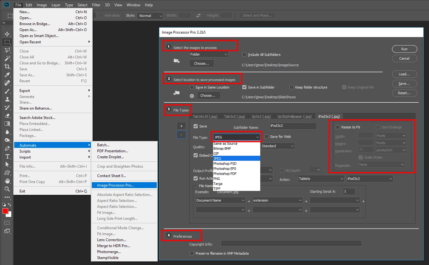

You do not need any Action to do what you what you want.  You could download and Install Image Processor Pro and use that.  With that you can save out up to ten output image files for your files the type and size you need.  Just add and remove tabs. You can if you needed include  action for each output image produces to add additional custom processing.

If that is what happen with those Tiff and your action we would need both you action and  some sample tiff you have problems with to see where your problem is.  Most likely the problem is in your action on how you set the batch options.

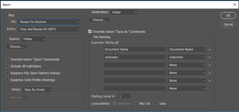

Even If I had your action and Tiff I could not test for I could not connect to your remote sever your action is saving to unless you override save as in your batch setting which you did not post.  Additionally  Adobe does not officially state that Photoshop will work with network file servers. However, your problem is most likely related to Photoshop behavior.  Actions can not use logic so they have a limited saving ability they came not use logic to generate filename they have to relies on Photoshop behaving a particular way.  The problem is  Photoshop behavior may change if all document conditions are not the same.  I also do not use save for web is actions and it looks like you have here and I also do not  know if save for web can be overridden when batched.    I'm not familiar with Photoshop behavior when saved for web is used when an action is played.
