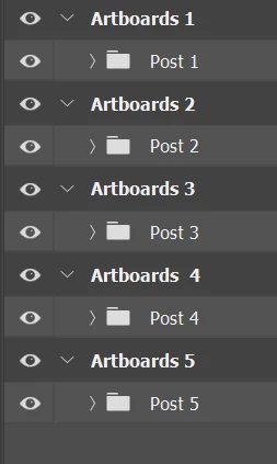

I have a batch of PSD files, some of which contain multiple layer groups as shown in the above image. The number of layer groups in each file is uncertain. I've written a script using ChatGPT and Claude to place each layer group on a canvas, with the canvas size being the same as the original file. However, I can't seem to get it to run successfully. The desired outcome is as shown in the image.

Thank you very much for your reply. After searching for relevant information, I modified the script. Now the script can successfully create multiple artboards and arrange them neatly. However, I am unable to move layer groups like Post 2 to their corresponding artboards.
