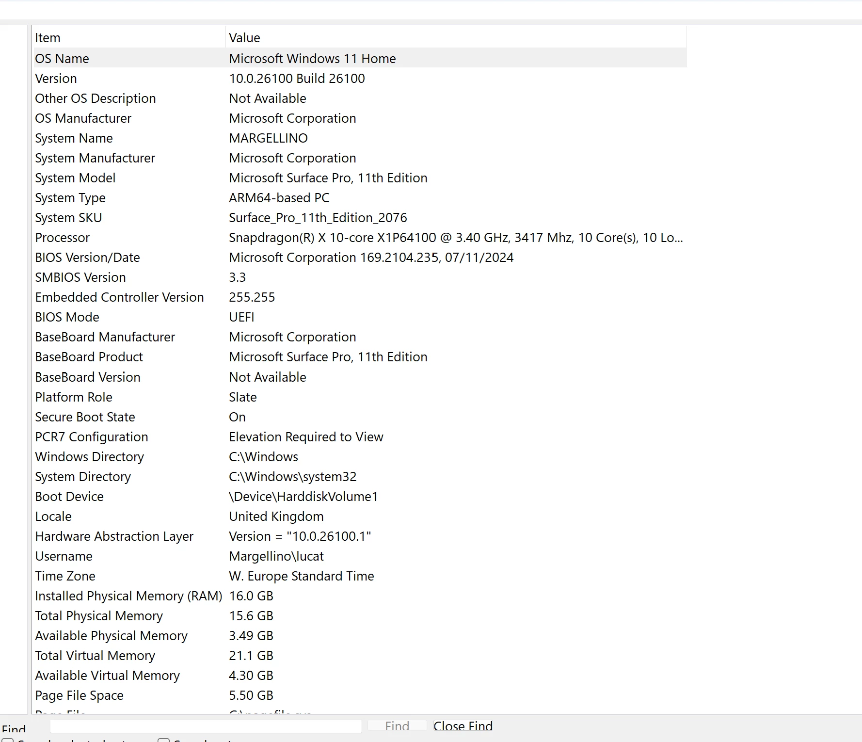

PS version is 26.2.0 and I run it on a Surface Pro 11 with Windows 11. (see system info attached).

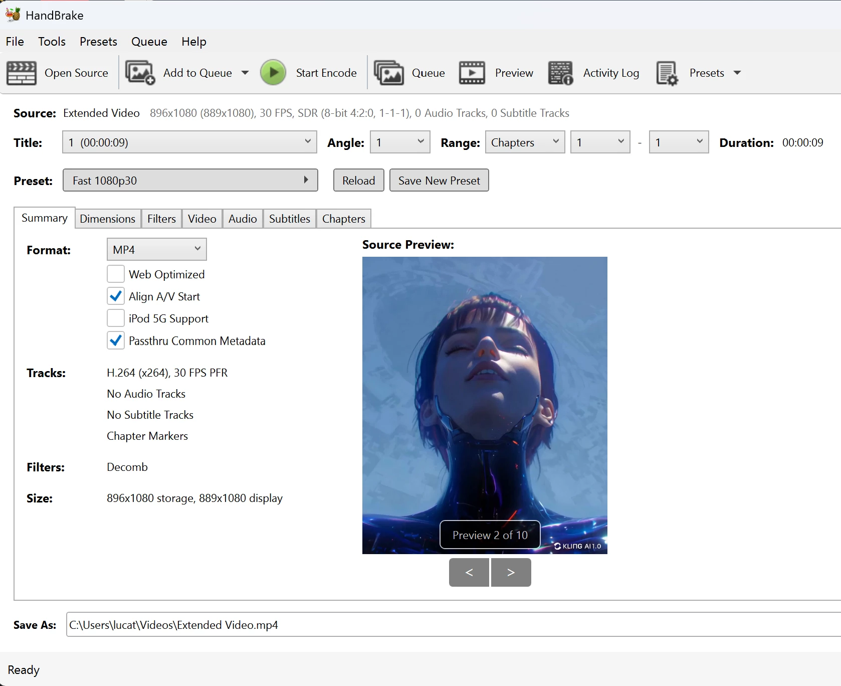

The file used is an .MP4 / H.264 / 30 fps (see attached).

To add to what advice has been written by Imaginerie, i believe the issue is that Photoshop on Arm PC Processors does not support video operations as it seems to indicate in this Adobe KB:
https://helpx.adobe.com/photoshop/kb/windows-arm-support.html

I think that the point is this one. I tried with too many variations of file type, codec, and so on...
I don't understand this ARM shift for Surface, it just created a number of compatibility issues. Thanks

I am starting to think that it's a problem of compatibility with the GPU of this bloody Surface Pro 11. This machine has only problems (they changed the chip, no intel anymore). I hope I'm wrong as in this case I just have to change the pc... thanks again.
