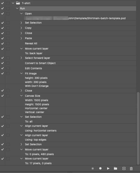

Stephen Marsh
Oct 9, 2024 2:38 AM UTC

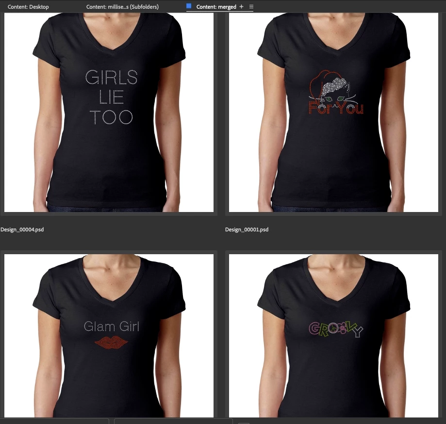

Here is the result of an action as I previously described:
For such work, taking the extra time to setup a displacement map in the action to distort the design to the underlying contours adds that extra bit of realism.
The first 4 steps of the action could be removed and would run faster if the clipboard was "primed" with the template image content before running the batch.

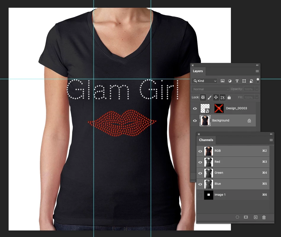

Oct 9, 2024 1:39 AM UTC

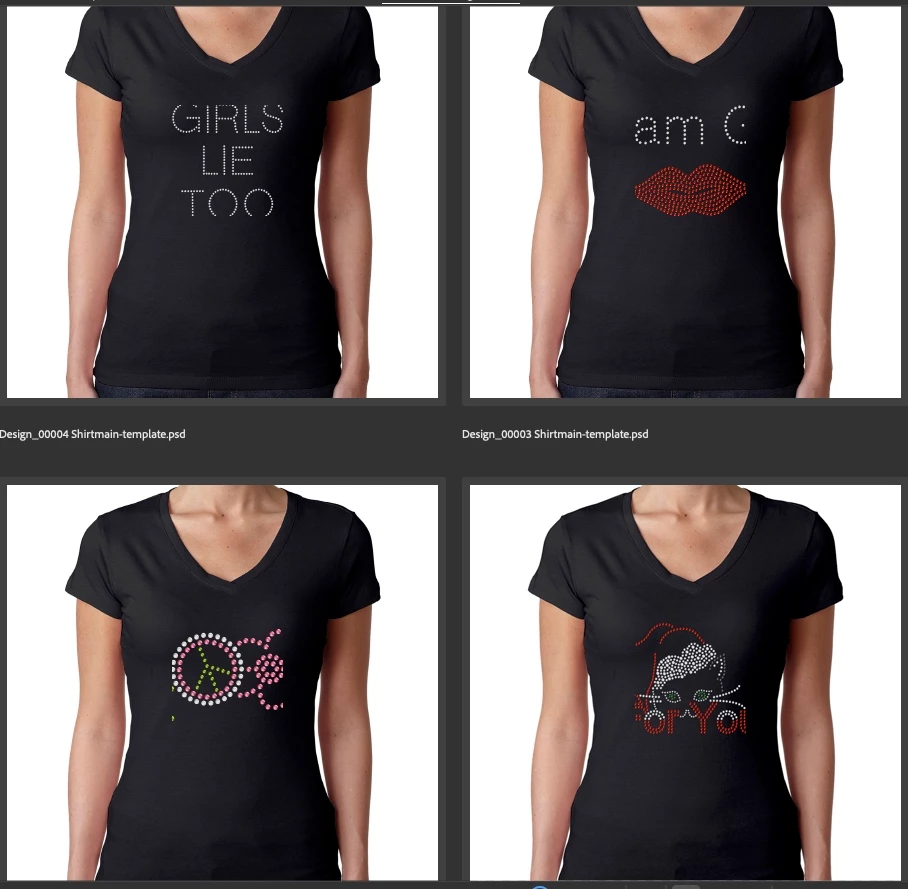

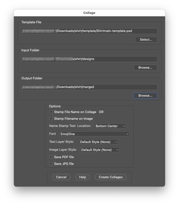

I tested the late JJMack's "BatchOneImageCollage.jsx" script which created the layered files nice and fast using the "Image 1" alpha channel for sizing and positioning:
However, as the script masks to the area defined by the alpha channel mask, the result isn't 100%. When I disable the layer mask to remove the cropping, the design is wider than the intended result indicated by the guides. The script would either need to be modified, or a second pass batch process action or script would need to rework the initial result.

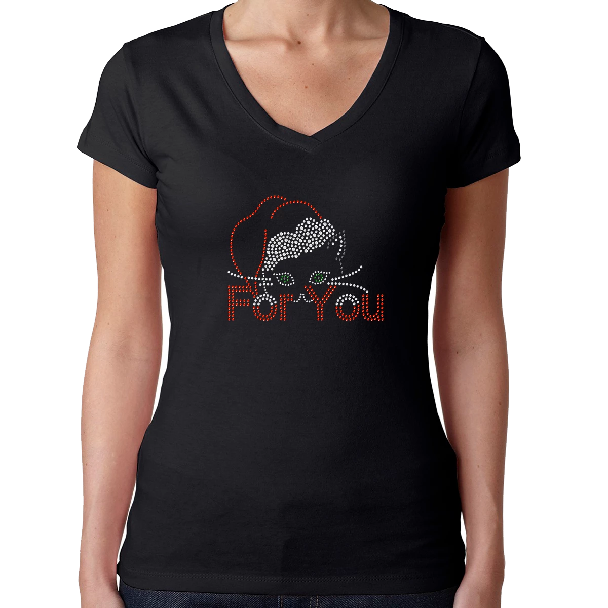

Hi Bojan, The shirt is the main image (1200 px) I need to add the PNG Files (i have more than 800) and save each one with the shirt.

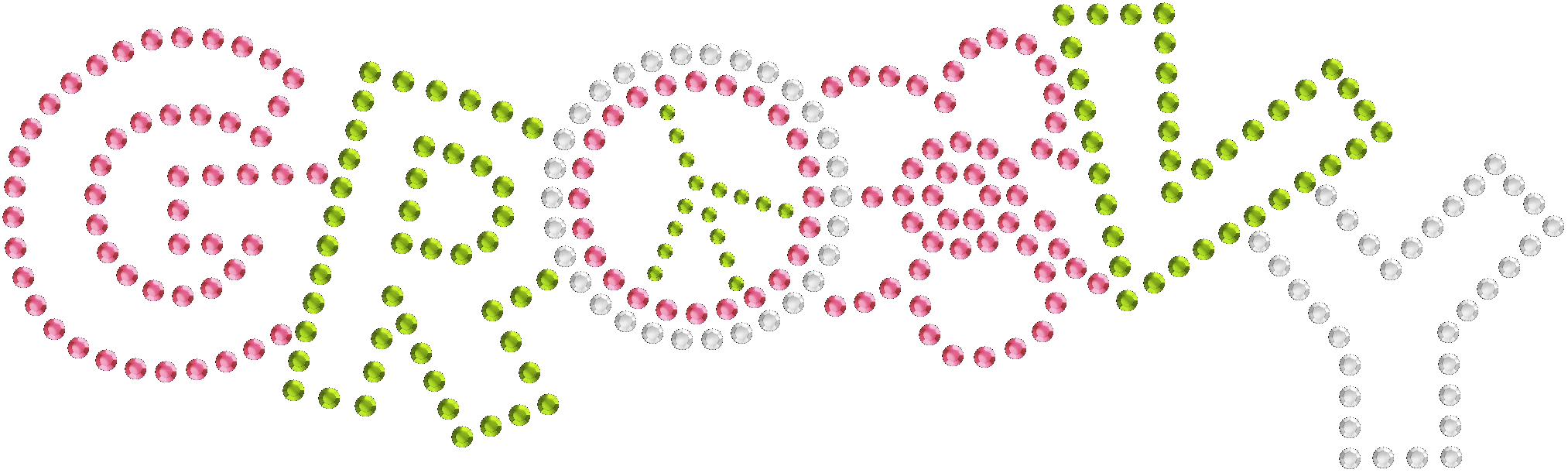

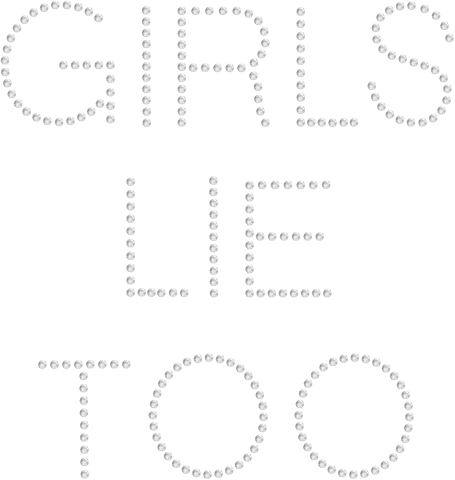

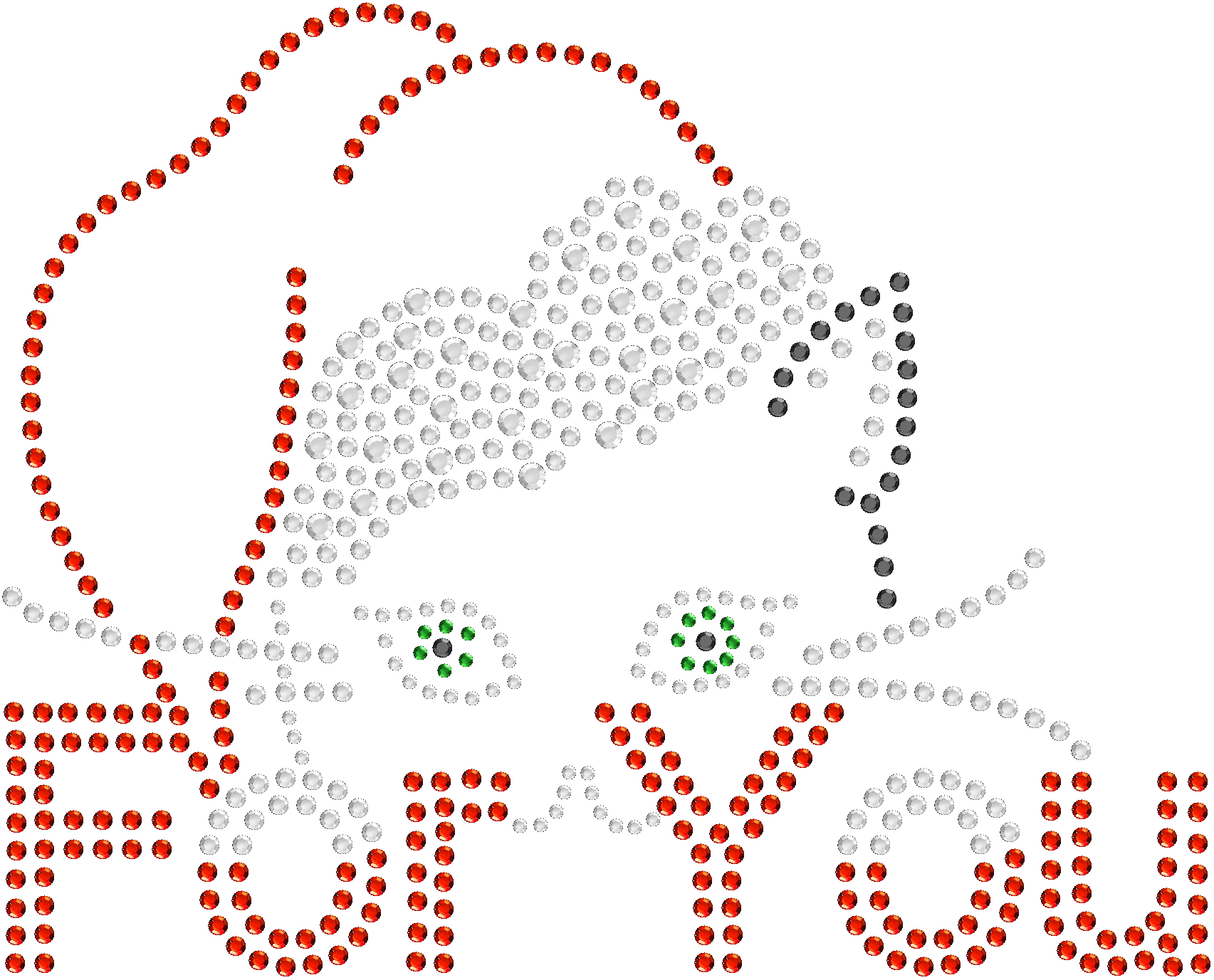

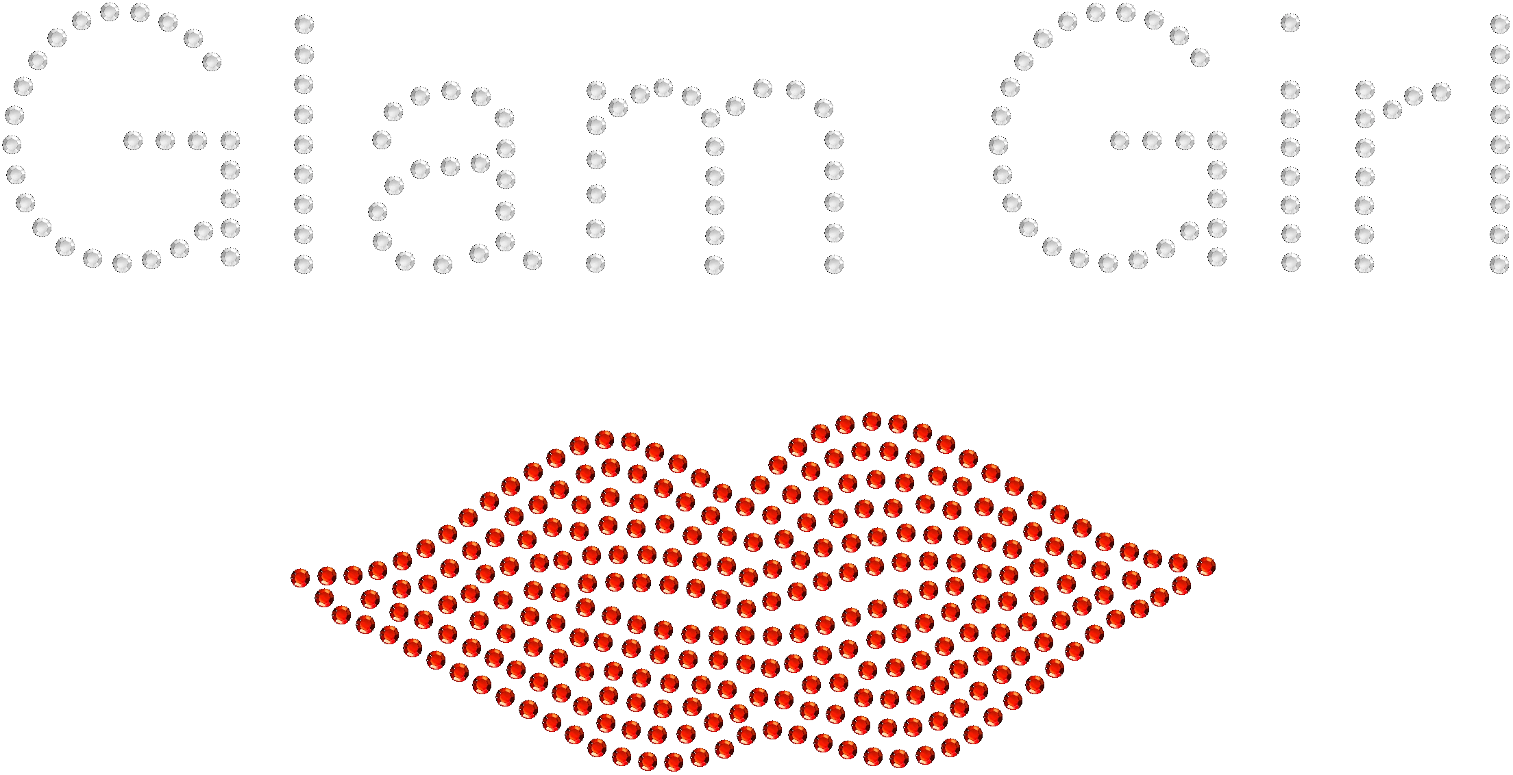

I'm attaching the shirt, the png (Cat) and the desire final image, I'm attaching other PNG (they are all different sizes)
I tried to do an action where I placed a PNG, resize it and center it, and save it, so it can do the same action on a batch, no luck. I did it before, but i cannot remember how.

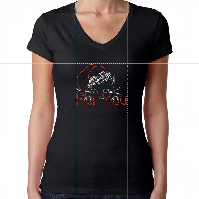

Oct 8, 2024 11:55 PM UTC
@silviob65797187 – Your example image is 1200 px square, however the original background is 1500 px square.
Will the 1500 px image be resized to 1200 px before combining with the transparent PNG files?
Or will the composite images be created at 1500 px (to preserve maximum resolution) and you will then batch resize copies to 1200 px later for web publishing?
At 1500 px size, the design has an effective size of 390 px square (as indicated by the marquee selection in the screenshot).
At 1200 px size, the design has an effective size of 310 px (as indicated by the marquee selection in the screenshot).
Will all of the PNG files be top-centre aligned in the area as indicated here based on your sample? Or should they be middle-centre aligned in the area? Or...

You could use the following from the late JJMack:
https://github.com/MarshySwamp/JJMack-Archive
Specifically, the "PhotoCollageToolkit.zip" and the "BatchOneImageCollage.jsx" script. Another option is a smart object based script, such as "BatchReplaceOneObject.jsx" or perhaps "BatchUpdateSmartObject.jsx" script from the previously mentioned archive. In each case, you need an appropriate template to work with the script.
