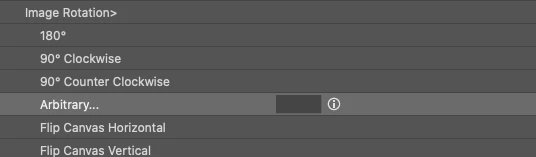

Have you checked your PS keyboard shortucts under Edit to make sure they are set to default?
There isnt a default keyboard shortcut to rotate canvas but there is a slot available for "Aribitrary" - is there a value in there?

I combed through every shortcut option - there is no entry in the "Arbitrary" shortcut.
