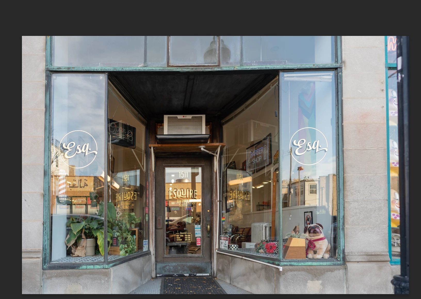

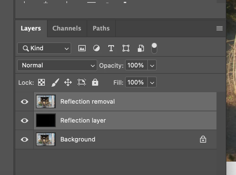

    Oct 13, 2026 11:10 PM UTC
    Here’s the image and the layers panel. Thanks!
    nik.m
    Oct 14, 2026 8:16 PM UTC
    Thanks for sharing the images! We'll share the information with the product team for investigation. Meanwhile, please go to the Help menu in Photoshop, then System Info, and copy the text. You can share the info with us either by pasting it as a reply here or by sharing a text file with us.
