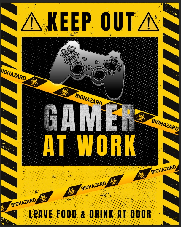

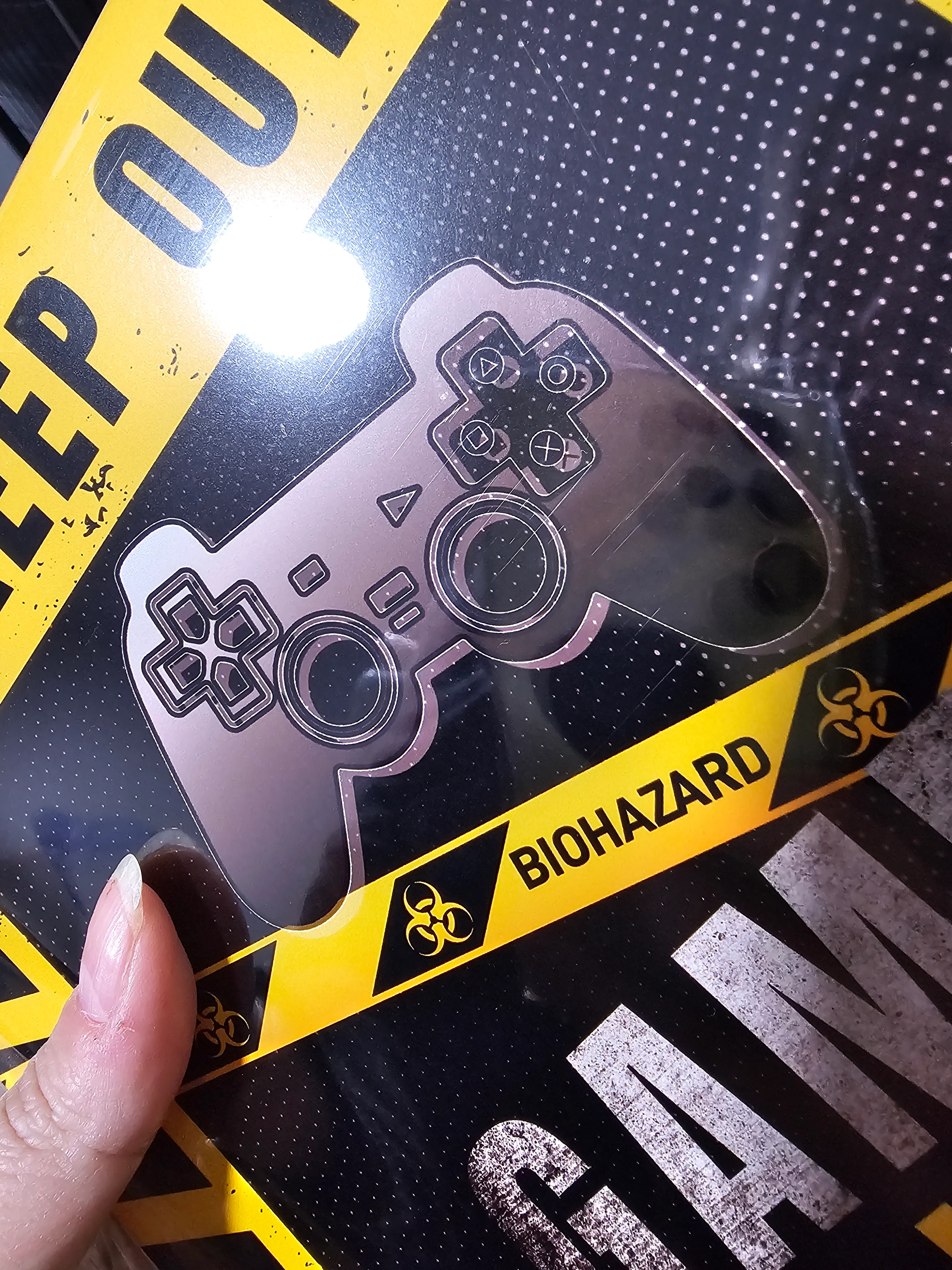

#1.  Blacks that are clearly black on my screen print brown.  Browns print green sometimes.
#2.  I understand I'll never get the colours EXACTLY the same, but I'd like to figure out how to get them as close as possible to what I see on my screen, but there's quite a significant difference in some cases.  One of the files you'll see - the game controller is 100% black in the original PNG, I haven't added a gradient or any other effect.  The black "caution" prints black wonderfully but the controller goes brown.

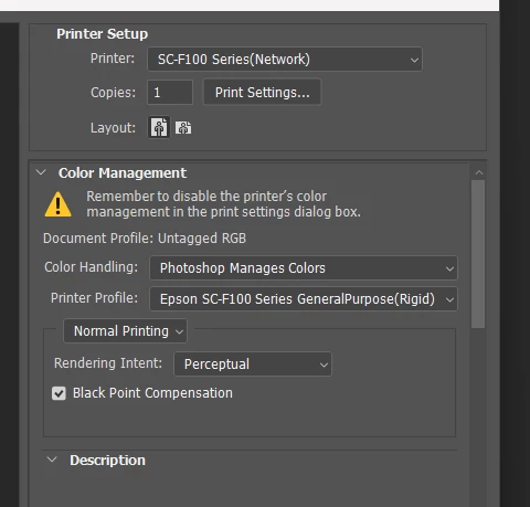

#4.  When I'm printing, I've let PS manage the colours and I get crazy colours - with the printer profile selected.  If I let the printer manage it, I don't get the wild neon greens and dark browns but it's close.

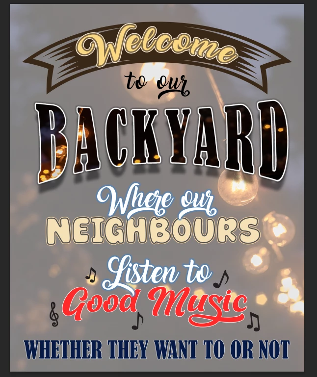

#5.  How come the frosted look doesn't translate to print? Is there a way I can make that happen or is it the substrate?  Is this achievable only on screens? (Not a priority - just wanted to know).  It looks so much better on the screen - effect - than it does pressed.

The printer profile needs to match your printer, inks (are you using Epson or 3rd party ink) and media (Epson or 3rd party media). Although correct settings for the ink and sublimation transfer material is very important, the output profile also needs to be measured on the final aluminium material, with the same application time, pressure and heat settings as you use in production. Note that a special spectrophotometer is required for measuring reflective metallic materials, unless the aluminium substrate has a white base colour applied.

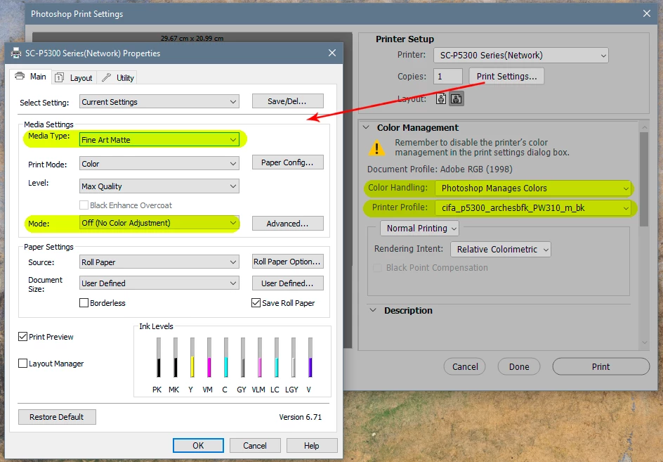

First of all, no file should ever be untagged. That throws everything to the wind and anything can happen. Always make sure the file has an embedded profile. It's not important which one it is, as long as it's the one the file was originally created in and that it's there.
Second, don't print from CMYK files. An inkjet printer is an RGB device that excpects RGB data. Inkjet printers today usually have more than 4 inks anyway, so CMYK makes no sense.
Third, you need to have the correct printer profile. That profile is media specific! It will be named with the paper manufacturer + paper quality. If the paper is from the printer manufacturer, the profiles will be installed along the printer driver. For third-party papers, you must download from their site.
Fourth, set media type in the printer driver. This controls total ink. If Photoshop manages color, turn off any color management in the printer driver. You don't want double profiling. Note that most lower end consumer printers don't support this. In that case you need to use Printer manages color.
