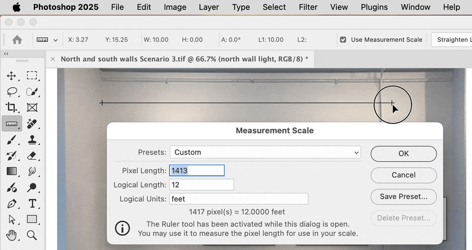

    Conrad_C
    Jul 25, 2025 8:50 PM UTC
    You don’t have to do much math if you use the command Image > Analysis > Set Measurement Scale > Custom to calibrate the Ruler tool to the known dimensions of that object in your photo like the sofa width. I did this to fit my mockup of specific frame sizes onto a photo of a wall at a site.
    You mentioned that you’re using CS6. This feature might be available only in the CS6 Extended edition; because CS6 is now 13 years old I’m not exactly remembering if it’s in the standard edition.
    andy_8039Author
    Jul 25, 2025 9:19 PM UTC
    Thankyou but im afraid im not skilled enough yet to actually understand what you mean.
    Conrad_C
    Jul 25, 2025 9:38 PM UTC
    When you use the Ruler tool with the Use Measurement Scale option enabled, the readout in the options bar isn’t reporting pixels, it’s reporting the real world measurement in the image, based on how you calibrated it in the Measurement Scale dialog box. So in the demo below, when you see W and L1 reporting 12, that’s 12 feet on the real wall, not 12 pixels in the document.
    For all the details, read the Adobe help article about measurement:
    https://helpx.adobe.com/photoshop/using/measurement.html
