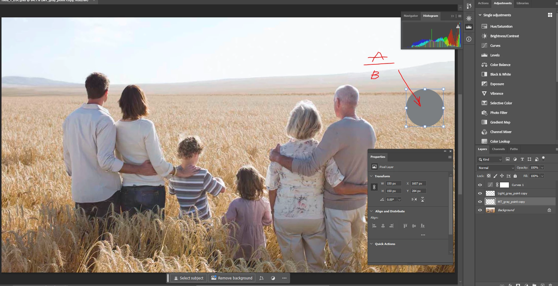

I have two layers of color on top of each other, is there a way to calculate and hide the layer with less or lighter color?
I would like to ask for a script to do that

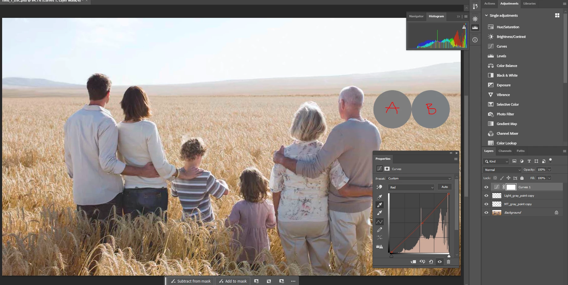

December 29, 2024
My needs were pretty simple, This program helped me turn off the layer that had less vibrant colors (which is a sign that less data was collected). So I kept the original program but I think you can definitely name the layer.
So far it works pretty much like I wanted.
For the action script I created two color samples from the source light and a midtone and overlaid them on two circles to select.

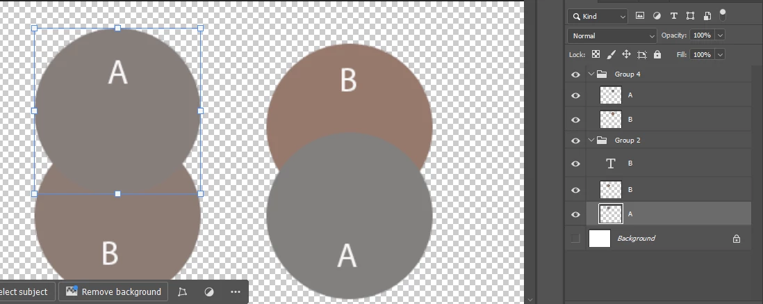

December 23, 2024
@powerful_Zephyr5EF9
Your request isn't clear to me. Can you please explain the process? Step by step...
For example, based on your screenshot:
1) The user will manually select the lowest layer
2) The script will compare the selected layer to the layer directly above and hide whichever of the two layers has "less colour"
Or do you want to do something else? What relevance do the two groups in your screenshot have?
December 23, 2024
I find the neutral gray point of an image using two methods:
When the image is well exposed, neutral gray point A has more color and B has less color and is lighter.
When the image is not well exposed, neutral gray point B has more color and A has less color and is lighter.
Photos from birthday parties, graduations, or trips often contain many images with unstable exposure. so i have to click many times.
I stacked them on top of each other and created an action in Photoshop to call the curve and used the auto click program to click exactly at the point where the two layers A,B overlap.
But the new problem that arises is that when stacking, I even have to hide the mismatched layer manually.
So I want to find a way to automatically hide the inappropriate layer (the layer with less color)
