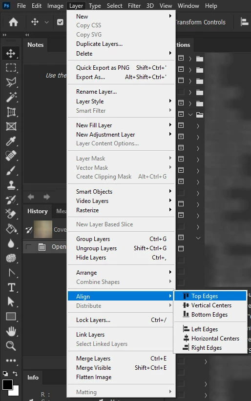

JJMack
November 2, 2021
Actions can not Capture things they are recorded steps with settings. Action can use Align to Alignmnent The alignment will be recorded into the action step's settings.
Menu Layer>Align Layers to Selection>Alignment
JJMack
Simonetos The Greek
November 2, 2021
Ok with capture I mean the record action, excuse me!!!
There is no such option in the Layer menu...
JJMack
November 3, 2021
Did you have an Active selection  when  you tried to Record Align Layers to selection? Was there a selection to align to?
