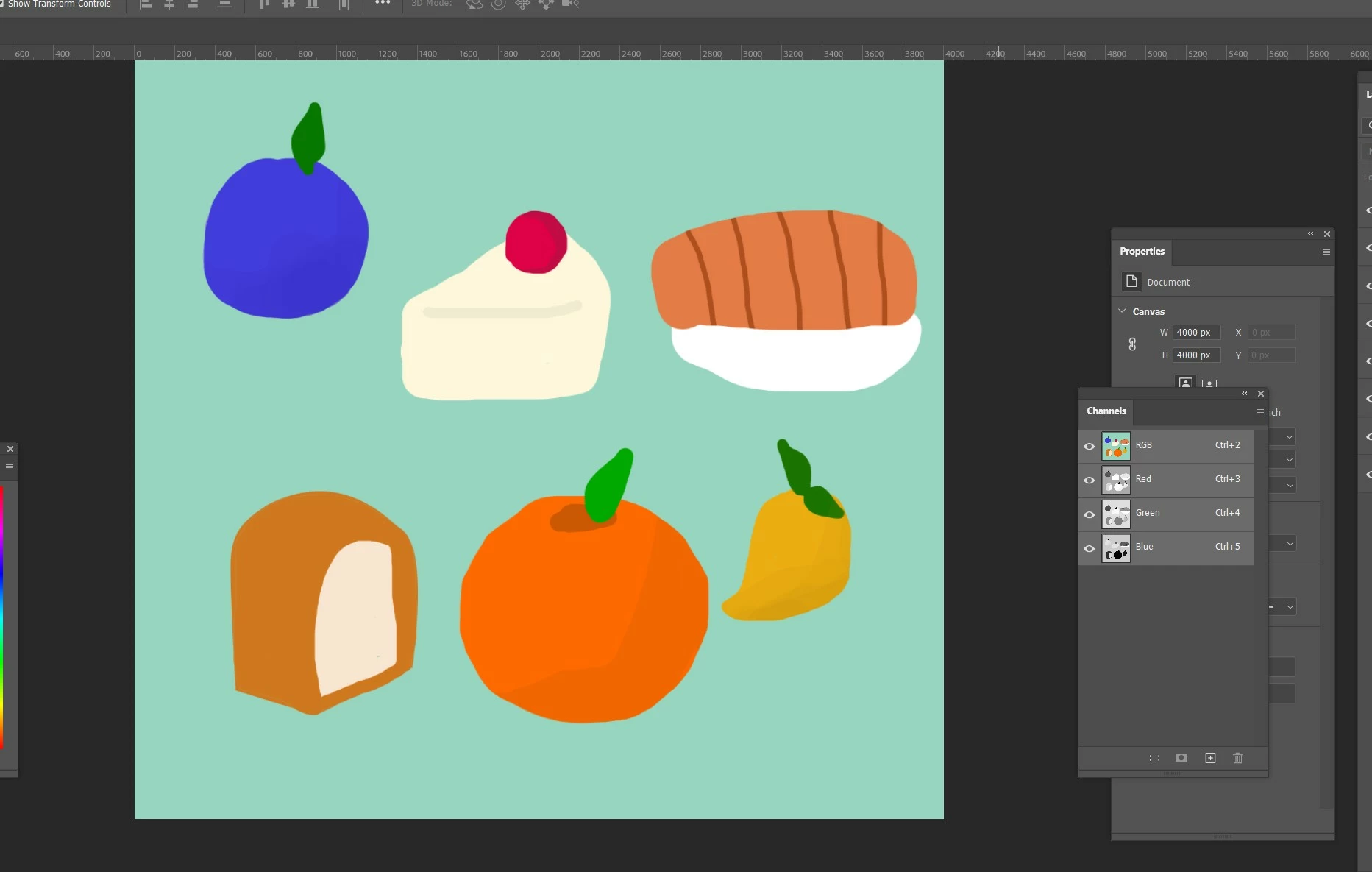

How can I convert color into this format
I know very little about photoshop. Is there any way I can convert my original artwork into this black and white format? I drew it in RGB, but I find this 'red' channel  very cute. I want my artwork to be saved and later to be animated maintaining this black and white shade. I tried saving my art work by only keeping the red option ON but when I open the psd file it goes back into RGB.
can anyone help me. Thank you.

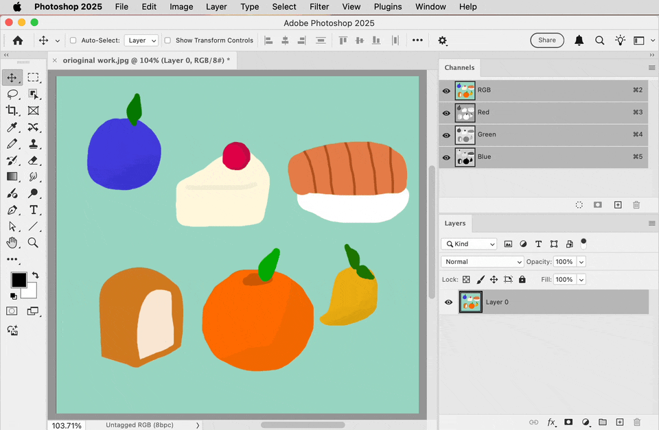

Stephen Marsh
Stephen MarshCorrect answer
February 27, 2025
Thank you so much. I will try it. I am grateful  to you for this post link.

Here is a custom script for you, no adjustment layer is necessary, the grayscale conversion will use the red channel. Updated to a 1.1 version using smart objects/smart filters.
Press "Yes" to process ALL layers or "No" to process only the selected/active layers.
Note: Locked layers are skipped, although that is easily changed if you wish for the script to automatically unlock them.
Layers to Gray Based on Red Channel.jsx
Stephen Marsh
v1.0 - 27th February 2025
v1.1 - Adds a smart object / smart filter for lossless conversion of colour to gray
https://community.adobe.com/t5/photoshop-ecosystem-discussions/how-can-i-convert-color-into-this-format/td-p/15179655

  1. Copy the code text to the clipboard
  2. Open a new blank file in a plain-text editor (not in a word processor)
  3. Paste the code in
  4. Save as a plain text format file – .txt
  5. Rename the saved file extension from .txt to .jsx
  6. Install or browse to the .jsx file to run (see below)
https://prepression.blogspot.com/2017/11/downloading-and-installing-adobe-scripts.html

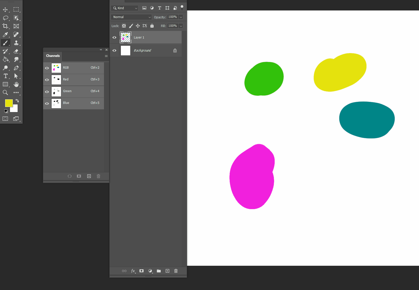

Conrad_C
February 27, 2025
quote
By @S_ A
The reason that didn’t work is that changing the visibility of channels is only a change to the view settings, not to the file itself. It still has all of the channels even though you are only viewing one of them.
If you like the red channel, then you can throw out the other channels and only keep the red channel, as shown in the demo below. These are the simple steps I used:
1. In the Channels panel, select the channels you no longer want. I selected Green and Blue.
2. In the Channels panel, click the Delete button (trash can) button.
3. With the other channels deleted, it is no longer an RGB image, it’s now a Multichannel image. But Multichannel images aren‘t supported in all software, so it’s a good idea to convert it to Grayscale. Choose the command Image > Mode > Grayscale.
4. Save or export a copy of the file in whatever format you need.
Edit: Oh, do you need to animate each layer separately? If you do, my method won’t work because it will flatten the file, so we’ll have to find another way.

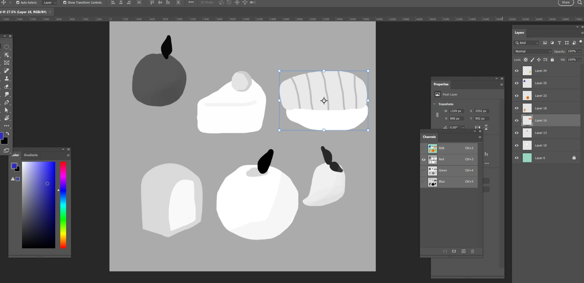

S_ A
S_ AAuthor
February 28, 2025
Hi, Thank you so much for this kindness. I run the script. I am getting an eror. Kindly take a look please. I am using photoshop 23.

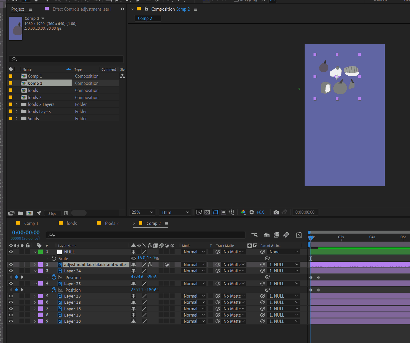

S_ A
S_ AAuthor
February 26, 2025
It dsnt help. I will animate the fruits. adjustment layers dsnt move when I move the fruits in AE= after effects  or do I have to copy AL= adjustment layers for each individual fruits ?  Do you know after effects also?  If yes, then I hope you will get what I meant. But thank you so much. I learned a new thing today. Thank you
Kindly see the attached file.

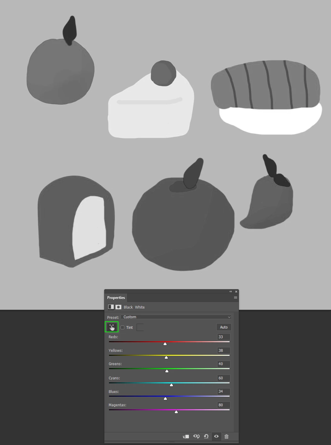

Trevor.Dennis
February 27, 2025
I am guessing that you spotted that can adjust the tonal value for each colour with the B&W adjustment layer?
If you click on the tiny hand icon, then you can drag the cursor left and right on an object, and affect its colour directly.
When you are happy, you can create a copy merged layer (Shift Ctrl Alt E) and animate that layer.
