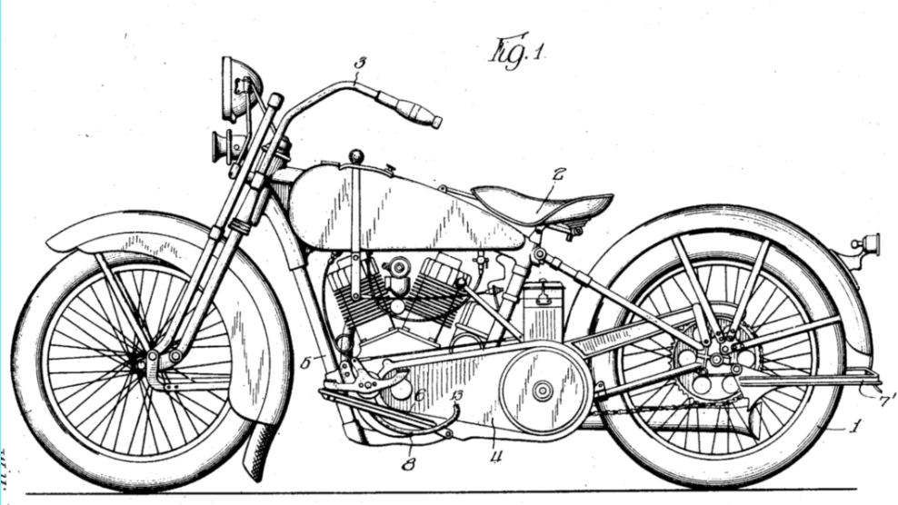

I like patent prints that I've seen around & would like to print some & I've got a production printing press which isn't getting much use currently (costing a fortune!)
All patent prints have black dots & speckles on them, how can i remove these from the artwork to make them cleaner looking?
(I'm just a dabbler in photoshop but I just want to know if it can be done & pointing in the right direction really)
The patent below has a lot of speckles. I would like to get rid of them but maintain the detail elsewhere.
Thanks, Karl

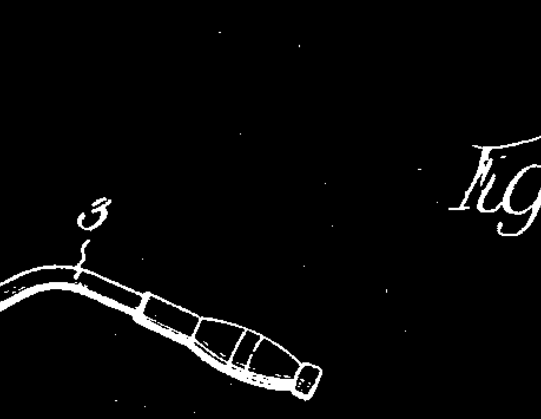

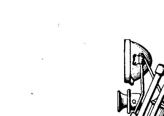

Norman Sanders
March 20, 2019
In this instance, it is far easier to see the specks as white on black.
1. Open the file
2. Image > Adjustments > Invert
3. Enlarge the view to 100%-200% depending on monitor size
4. Sweep across the black areas with the Brush set to black to turn the specks black.
5. Hold down the Space Bar to scoot to adjacent sections. (This goes very quickly.)
6.  When complete, choose Image > Adjustments > Invert.

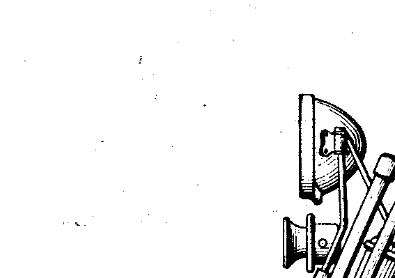

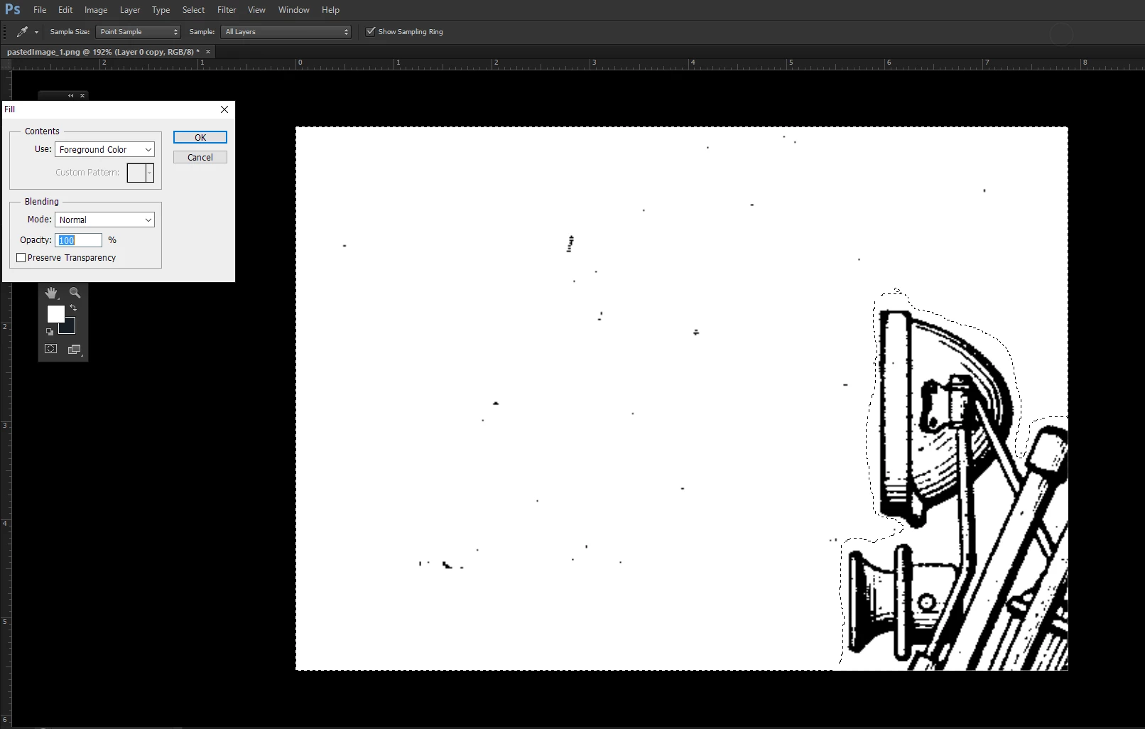

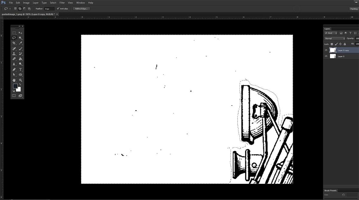

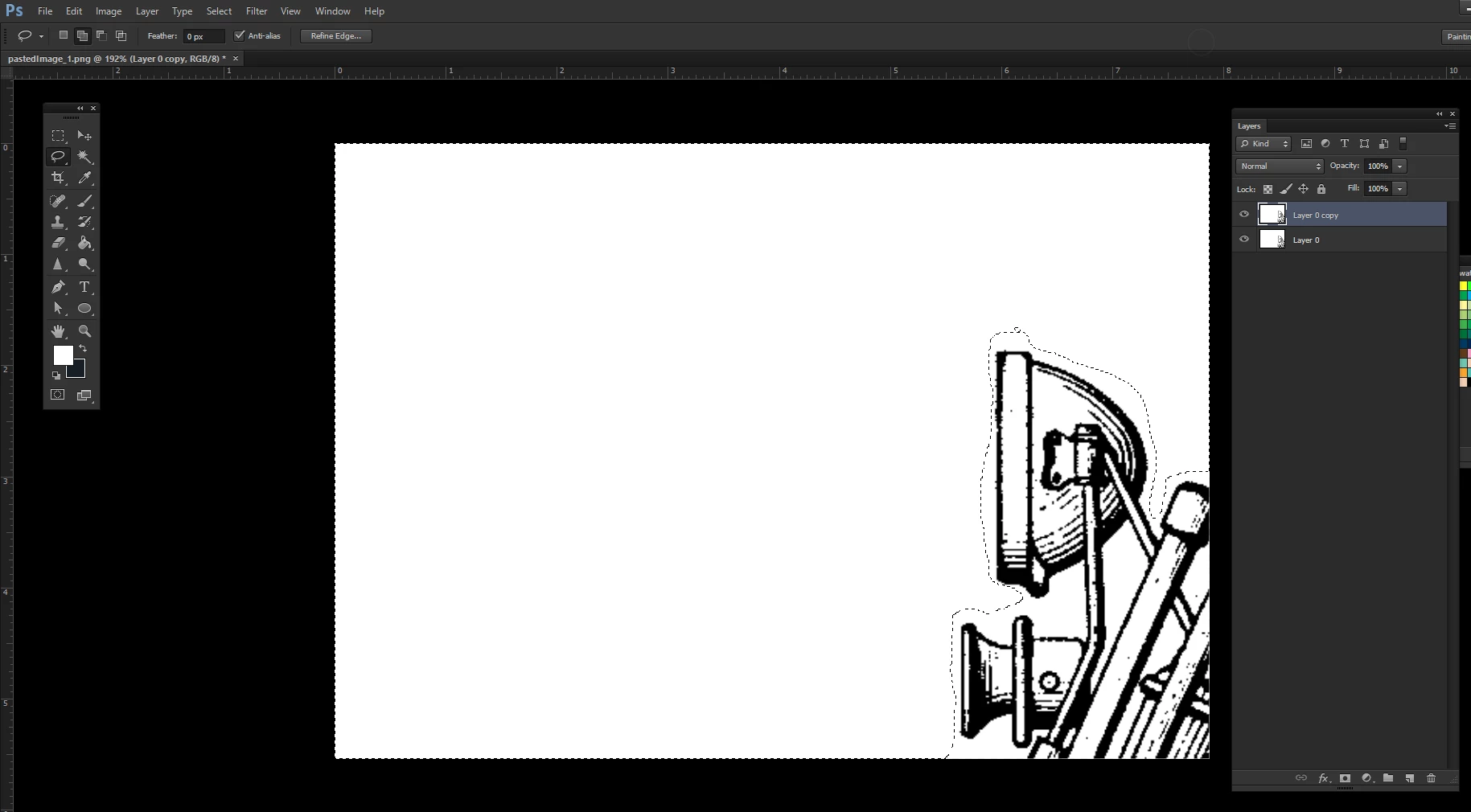

Leslie Moak Murray
March 20, 2019
Another way (and before you begin, either save the file under a different file name so you'll have the intact original in case of a mishap, or duplicate the layer and work on the duplicate):
Working in sections, make a selection around the large white areas:
Set foreground color to white, then Edit/Fill/foreground color
Ta-DA! Now go Select/Deselect, then go to the next area.

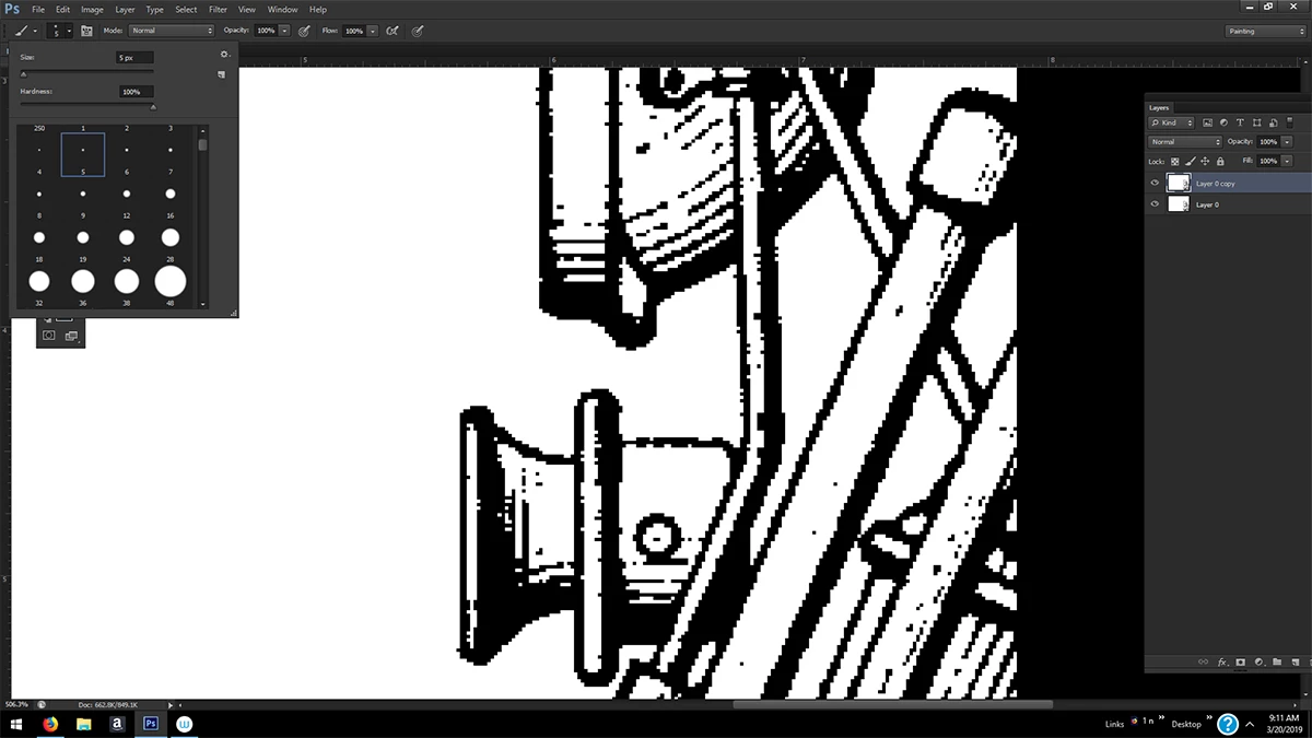

Now you can go to the brushes, select the size you want (4 or 5 pixels is good for most of it), and it should be set to 100% hardness, and paint over any last stragglers you find inside the small areas within the black line art.

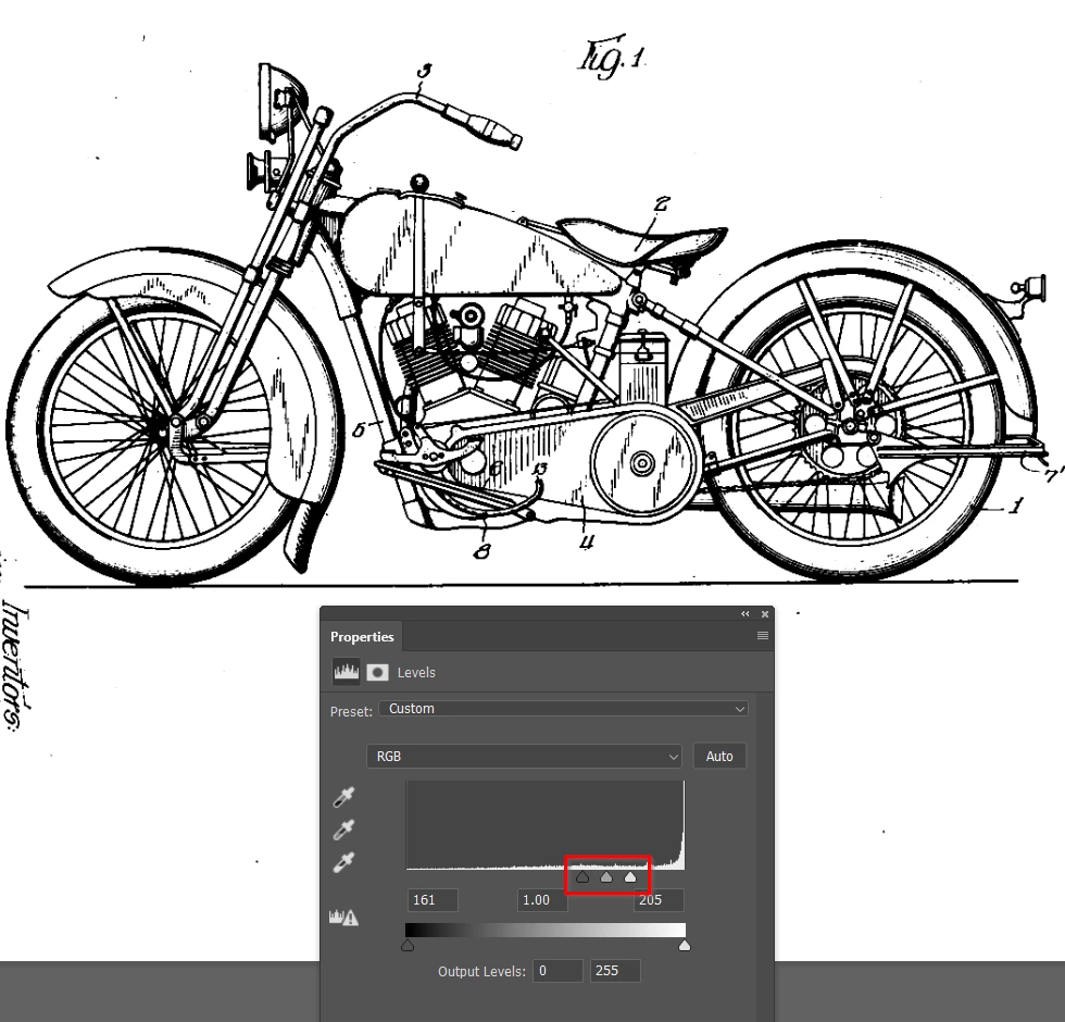

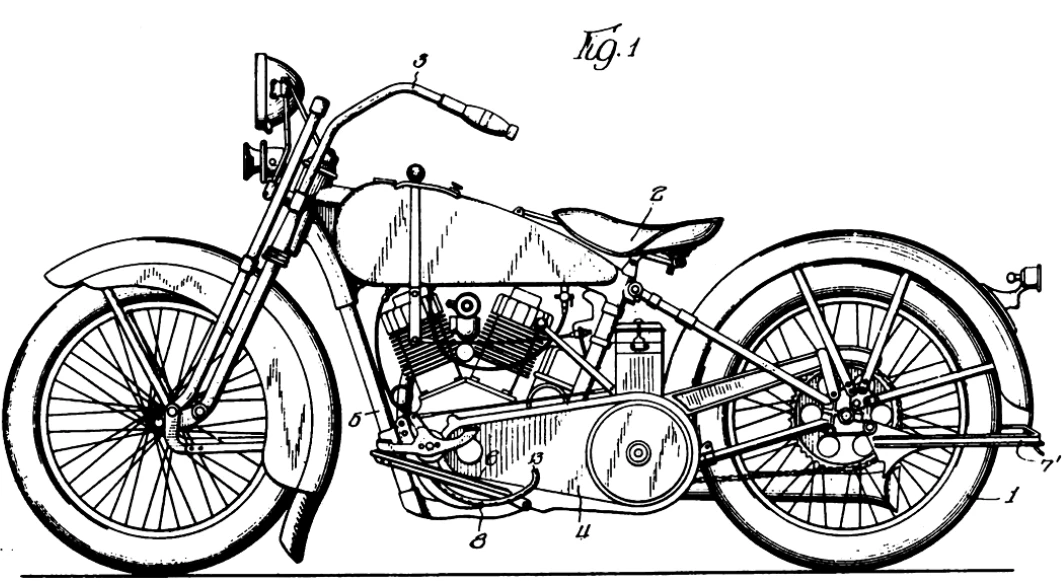

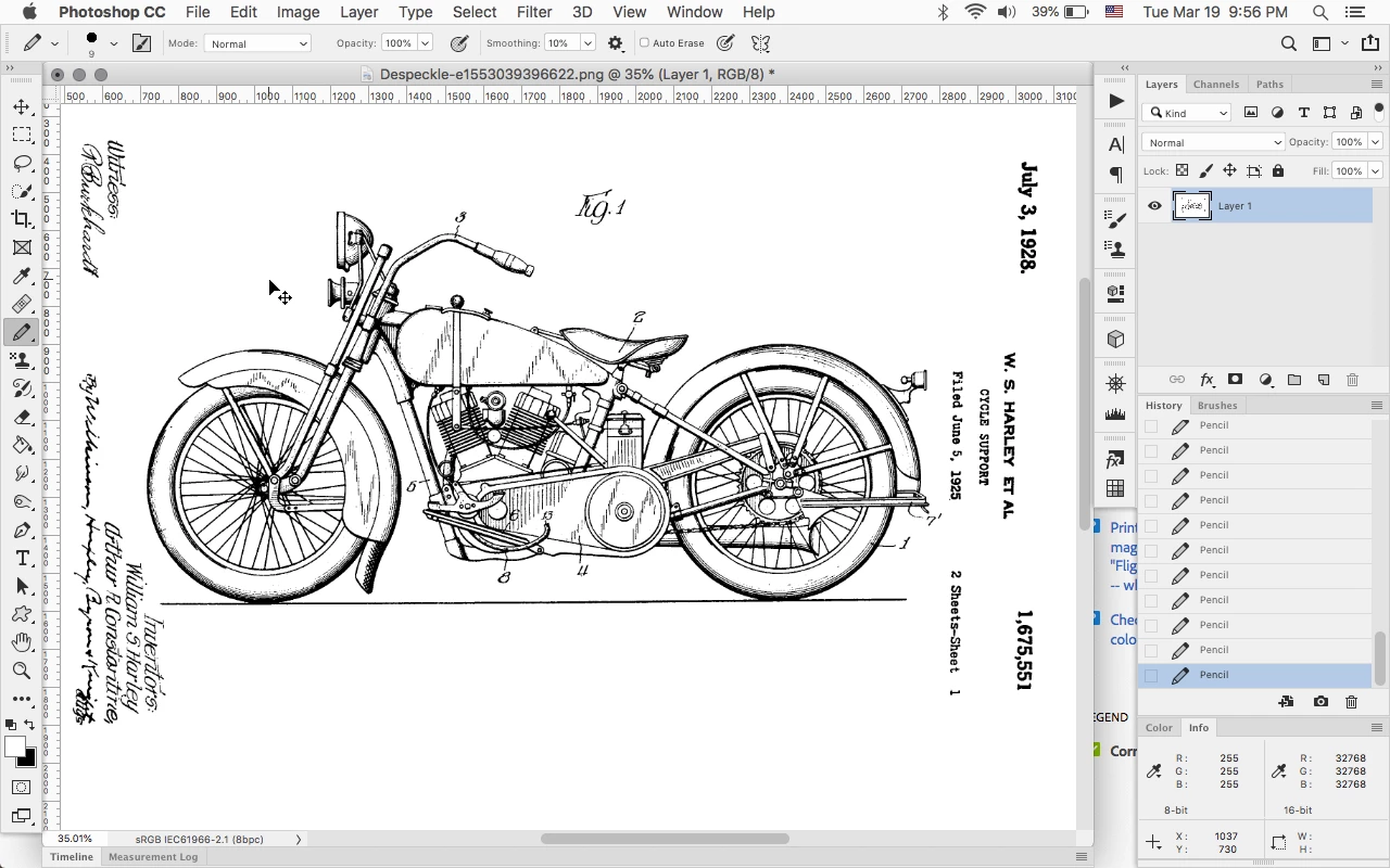

Trevor.Dennis
March 20, 2019
It's not an easy one because you'll lose detail before making a meaningful difference.
Dust & Scratches set to 1 pixel clears the smaller specs up without doing too much damage.
Use a copy of the layer, so you can mask back in any areas that
Before
After
I've just realised that your image is grey scale.  You can give yourself some more options making it RGB and 16 bit.
After converting  mode and bit depth, give it a very slight Gaussian Blur.  This with 1 pixel
Then use a levels adjustment layer to harden it up, but without losing the anti alias you have applied with the blur.
This gives you a blacker, smoother image.
You are not going to be able to do much more to it, because being so black and so white, sharpening is not going to be effective.  You could easily paint out the most obvious black specks though.

If you don't have illustrator you could just use the pencil tool set to white and paint over them.
D Fosse
March 20, 2019
+1
This looks like a perfectly manageable manual job with the pencil tool. A little work is not unreasonable, is it?
