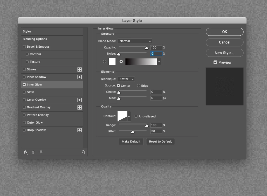

<<You edit the adjustment layer created by the action to alter the noise settings, not the action  and to double click the effects/inner glow under the main adjustment layer.>>
Your action creates a new layer with a grey box icon, layer name is Smart Noise, far right are two small overlapping translucent squares icon.
Firstly it has applied noise to ALL my layers, so right click and select the masking option, solves that.
Normally an adjustment layer that I use has a small downward pointing arrow (denoting its been related to the layer directly below, then a symbol such as set of scales for colour balance, then an upward orientated chain link then a white square. Click the scales and the palette open for colour balance.
On yours, nothing there of any of those.
I click the overlapping two squares, nothing happens, I double click it and ‘layer Styles’ appears, with no styles ticked.
I double click ‘inner glow’ though one click is sufficient, it shows noise as 0, yet I am seeing noise, so that can’t be it. And anyway there is no Gaussian or mono options there.
Just where are these settings to be found ? I look at the other styles offered, none have noise let alone noise with Gaussian and other options the noise filter gives.
<<As this noise is not using the noise filter, the settings are different. You will need to come up with your own settings and opacity in order to come close to the desired filter settings (try adjusting the Apodaca adjustment layer opacity to say 8%).>>

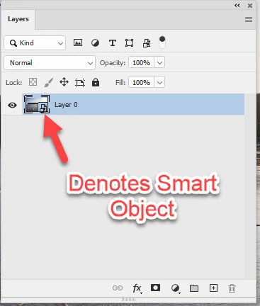

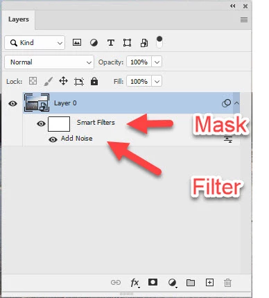

Feb 26, 2020 10:45 PM UTC
Hi when you convert to a smart object you should see this.
When you then apply a filter you should see this:

Feb 26, 2020 11:49 PM UTC
ah got it.
I then went filters>Convert for smart filters then filters noise add noise and added gaussian 0.7
However I am unable to paint onto the layer, I get a no entry symbol if clicking on the layer name, and I get to see my brush circle if I click on the white mask icon which takes on the active thin black line boundary, but when I start painting nothing shows, though history shows I used the brush ! I made sure no selection is running.
Merlin
