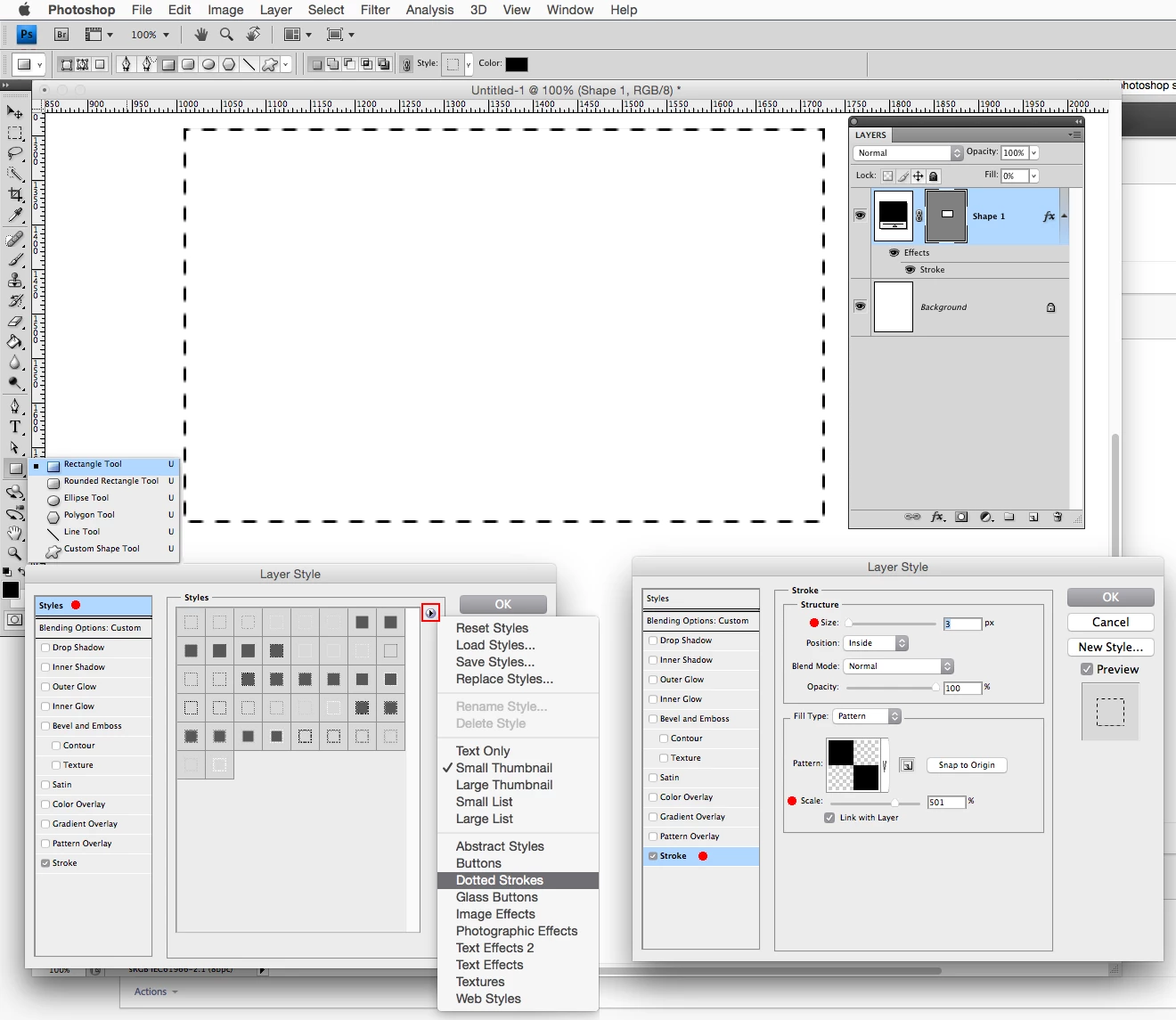

    You can try the Dashed Strokes layer styles in photoshop cs4.
    Though it's not easy to get it looking right, so you might try adjusting the Size and Scale to get it anywhere close to looking decent.

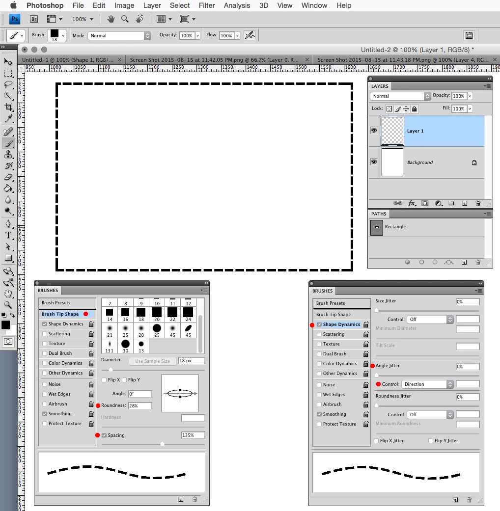

    You could also use the Rectangle Tool to draw a path and stroke the path with one of the Square Brushes.
    In the Brushes panel, one needs to adjust the Spacing and Roundness under Brush Tip Shape
    and set the Angle Jitter to Direction under Shape Dynamics.
    Still, i had to modify the corners with the pencil tool to get the below results.

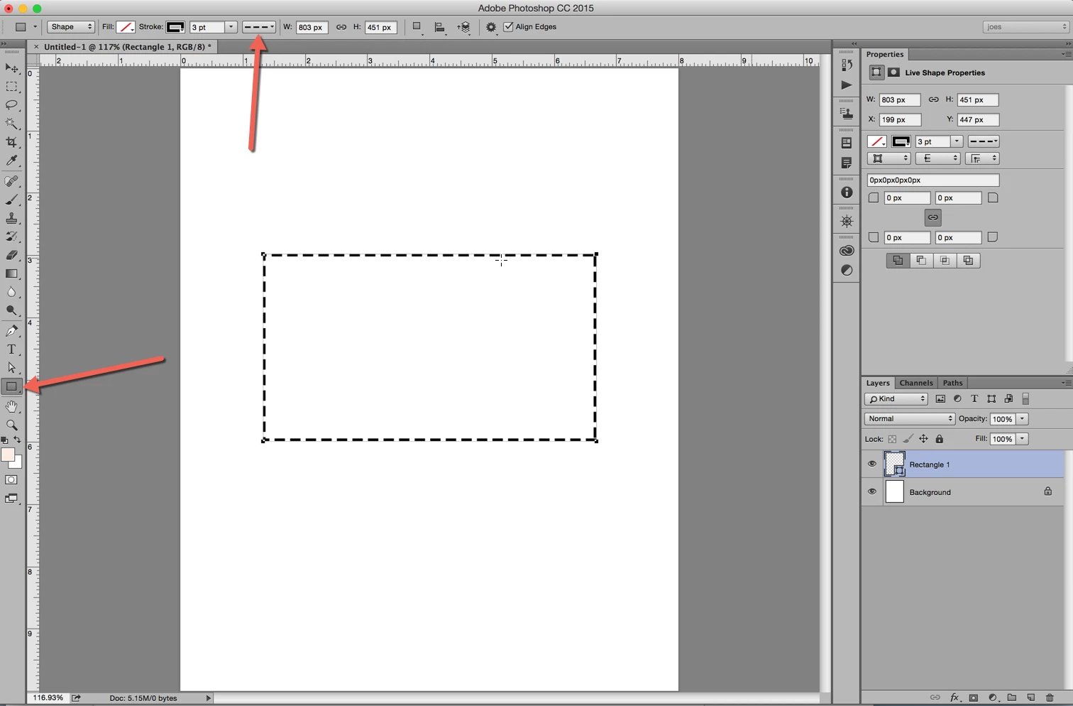

    Have you tried using the Rectangle Tool (not the Rectangular Marquee Tool) and selecting Stroke with a dashed line?

    Not even in Photoshop CC 2015 has the Layer Style that feature, but Shape Layers have, so one could create a Path from the Layer’s transparency and create a Shape Layer based on that.
    Your version is too old for that, but you may be able to create a Brush and apply that to a Path.

    I tried the bush, and it didn't use the spacing. In that old of a version, I think the only way is to manually mask out the lines, which would be a royal PIA.
