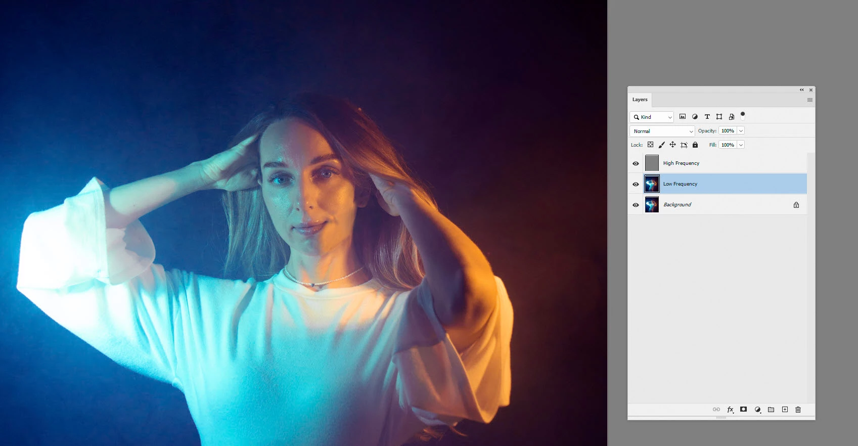

davescm
January 19, 2025
I would use frequency separation to separate the low frequency (tonal shades) from the the high frequency (texture detail) allowing retouching of each separately. To do that :
1. Make 2 duplicates of your image layer
Name the lower - "Low frequency"
Name the Higher - "High Frequency"
2. Select the Low frequency layer and use Filter Gaussian Blur (around 6.0)
3. Select the High frequency layer
Go to menu Image > Apply Image
Set the source layer to Low Frequency
Set the blending mode to Subtract
Set Scale to 2 *
Set offset to 128 *
Click OK
4. Change the blending mode of the high frequency layer to Linear Light
5. Now you can retouch each separately. I brushed colour onto the low frequency layer and then cloned out the shadow edge on the high frequency layer.
I hope that gets you started.
Dave
* Note - the above steps are for 8 bit/channel images. For 16 bit/channel step 3 changes slightly
Check "Invert" next to channel
Set the blending mode to Add
Set Scale to 2
Set Offset to 0
Click OK
Now carry on with step 4 above
